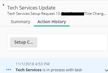

We rolled out our first form and users are utilizing the button that appears on the right column (summary/action history) that mimics the buttons at the bottom of form. The issue is when this occurs, there is no validation! All the required fields are left blank and the task is finished, which causes issues in later steps.
Button sample "Setup Complete"
How can I stop this from happening?

Go to the user task in the process designer and turn off Direct Approval for this task. If you allow Direct Approval (the buttons on the right side), you are allowing an approver to directly approve the task with no field information. If you want to require the fields, you have to disallow direct approval to force the approver to open up the form and fill out fields.
