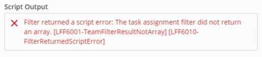

2. If I change this setup / the script to the below:
if($util.getValue('FIELDNAME') == 'AD\Username)
$result=team.findMembersByRole('ROLEASSIGNED');
if($util.getValue('FIELDNAME') == 'AD\Username')
This always errors out with the below:

replied on November 12, 2018
Hi Ziad,
Have you tried
$util.getValue('FIELDNAME') == 'AD\\Username' or $util.getValue('FIELDNAME') === 'AD\\Username'
Your comparison of 'Fieldname' == 'AD\Username' may not evaluate correctly due to the single "\".
