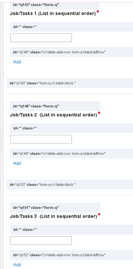

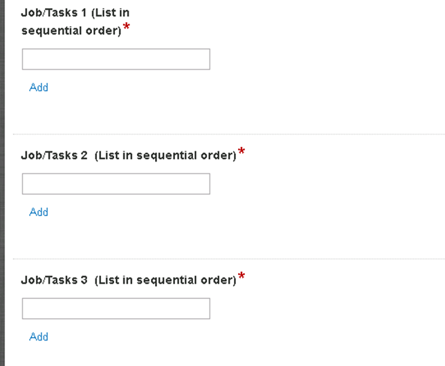

It didn't work or I am doing something wrong. I did change the "#q" to reflect my document but it still did not work. I would like the fields below to be side by side with the "Add" under each field. The reason is Job/Task 1 may only need one selection and Job/Task 2 may have three selections and Job/Task 3 my have just two selections.
I do appreciate the help.
replied on November 6, 2018
Can you provide the actual CSS you're using? The #q IDs need to be present for each of the collections/tables.

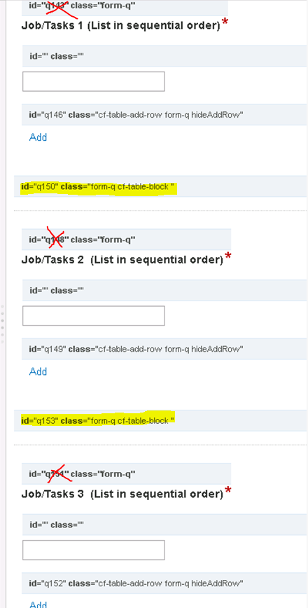

replied on November 6, 2018 Show version history
UPDATE: I think I see the problem. Your using #q143, #q148, #q151, but in your screenshot those appear to be the underlying fields, not the Tables.
It looks like it should be the #q150,#q153, etc. (I can't see the third one). Basically, you need to use the "q" value next to where the Class has "cf-table-block" not the one below it

No, the problem isn't the styling, it is the selectors you are using.
You need to go one level up because the 143, 148, and 151 IDs are referencing the child elements within the tables, not the table itself.
Yup, that is exactly what I just replied with as well. You are using the wrong #ID's those are selecting the columns not the entire table itself. Change the Id's and they will line up beside each other, but likely not straight, then use the
" vertical-align: top; " and you should be good to go. You may need to make some sizing adjustments in the layout tab on the actual tables themselves to make it look how you want, but that should get them lined up for you.

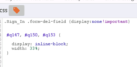

#q147, #q150, #q153 {
   display: inline-block;
   width: 33%;
  vertical-align:top;
I changed it and it made the boxes smaller but did not put them side by side.

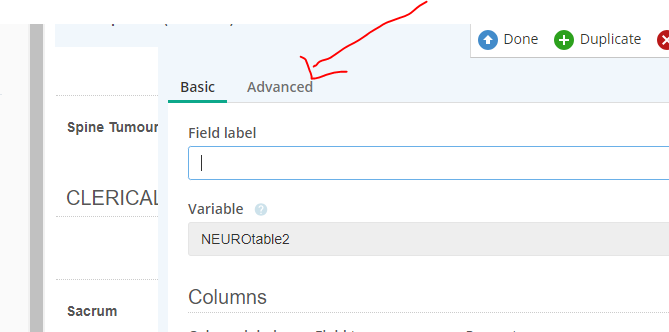

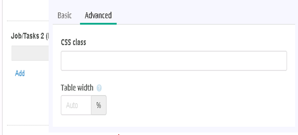

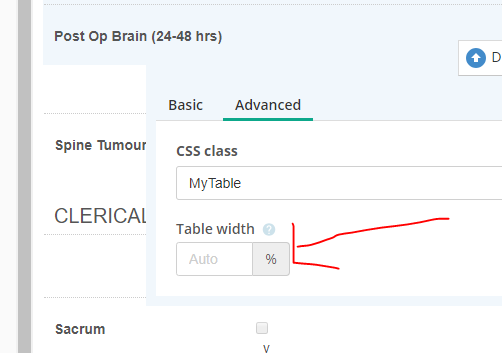

When you are in the layout tab, check the table width in the advanced tab for each table. I just tried it on mine and it worked fine (keep it on auto), so there must be something else conflicting with the CSS you are trying to do. You may also need to adjust field sizes and such until you get it looking how you want. If the fields are too big there will be no space for them to line up side by side. You can also adjust column, field and row label size on the layout tab.
I looked in the advance tab and I do not have anything in the CSS field. I do have
.Sign_In .form-del-field {display:none!important}  in the CSS and Java Script tab. Could it be the culprit?
I was referring to the advanced tab on the layout, in the actual table field.
That's correct. I do not have anything in the advance tab

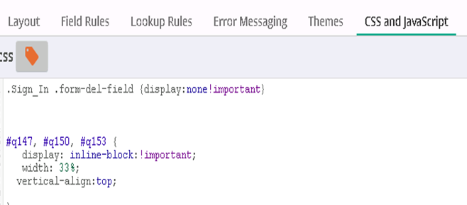

I do have this in the CSS and JavaScript tab.
It is adjusting the size its just not placing them side by side.
Gina,
The extra colon after "inline-block" is breaking the CSS.
You don't need the !important, and I don't think the vertical alignment is needed, so the following would be sufficient.
  width: 33%;
For future reference, if you ever do need to use !important, it should come after the style setting and before the semi-colon with no additional characters in between.
For example,
.h2 {
    color: red !important;
The additional colon you added breaks that line of the CSS, which is preventing the inline-block display style from being applied.

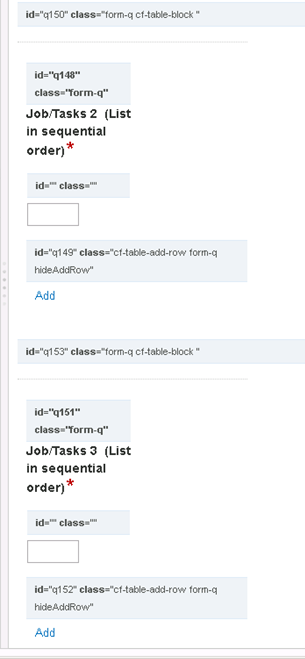

You aren't using the correct #ID's. From the screenshot you posted, the last 2 tables should be #q150, #q153 and the first one is cut off.

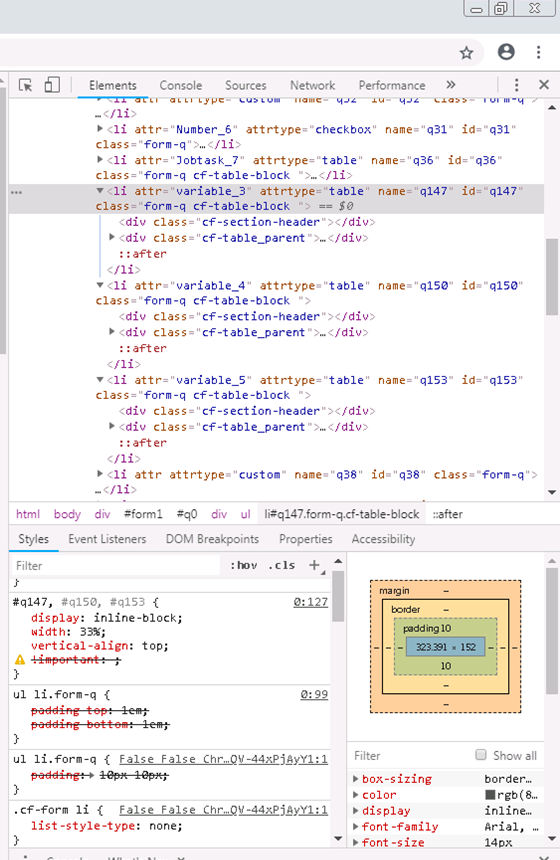

This is what it shows in the inspect.
