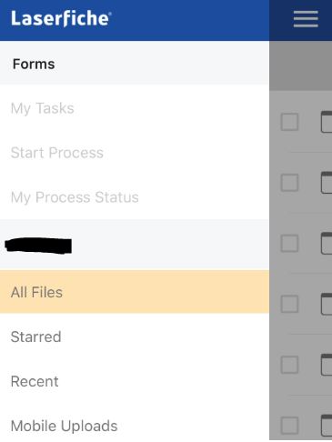

We have setup Public Address for our Laserfiche/Forms server which is one server, however when i login on the Mobile application it is not showing me any forms and it only shows the Repository Documents.

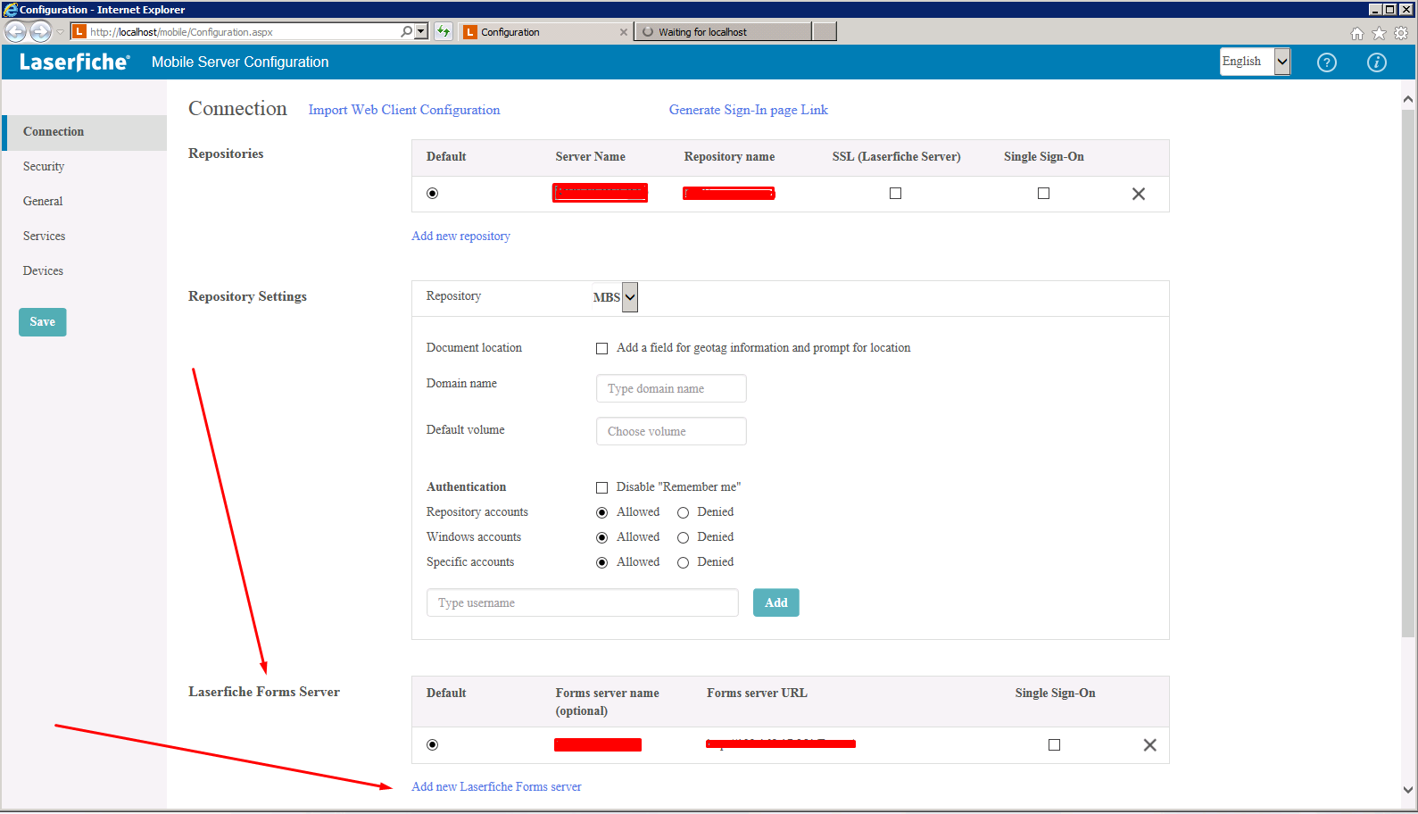

Things to check, have you configured the forms server in the mobile app configuration utility?

I have check the configuration, i have used specified forms and mobile configuration with internal details to test, i can see it is pointing to the correct address when logging into the app. I have tried the external address as well with SSL enabled on Forms Config as well as Mobile App Config. It is not showing the forms and it is greyed out on the mobile app, when i click on it then it asks me to login again which it seems logs in successfully, but then it is still greyed out. Web client has exactly the same configuration and it is working for without any issues.

Exactly that yes, browser on mobile or iPad works fine. On the app I am not able to see any forms.

I just ran into this, turned out if I logged into mobile as user@domain.com forms was greyed out, but if I logged as just user or domain\user forms was not greyed out.  We noted this on both the iOS app and the Windows 'mobile' app.
