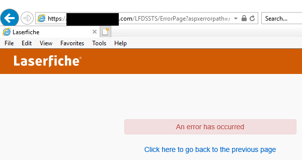

When users try to log into forms, they are redirected to the public facing LFDSSTS site and get an error page stating only that an error occurred.  It does not matter if they are trying to log into the public or internal forms server, they still get sent to the external STS site.

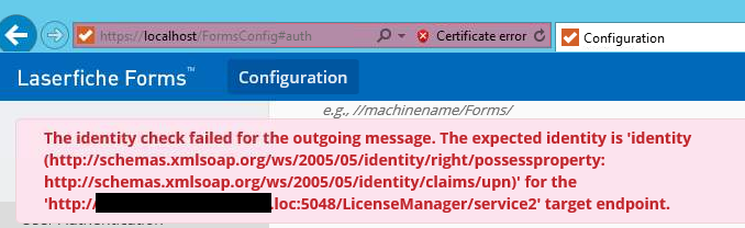

If I go to the external forms server and open https://localhost/forms I get error about client cert not provided

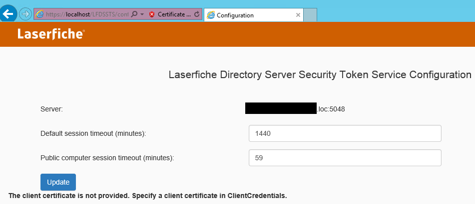

When I go to the external forms server and open https://localhost/LFDSSTS/configuration I also get a message about client certificate not provided.

  2. Opened a web browser and made sure that https://localhost/lfdssts/configuration properly loads. There was a message indicating that the expected DNS identity didn't match up with the DNS identity provided. To remedy this, follow the steps in the addendum of the SSO white paper from https://support.laserfiche.com/resources/3878/configuring-single-sign-on-for-laserfiche-web-products

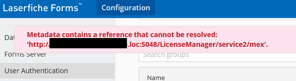

Now when I try to change the Authentication tab data and save it, I am getting
Any thoughts on where I need to look to fix the metadata?
replied on November 5, 2018
From the screenshot it looks like the server name has a ".loc" on the end; is this the correct FQDN of the LFDS server?
If the FQDN of the LFDS server is something like "LFDSSERVER.loc" then this is not going to match the wildcard certificate, and you should have a DNS entry that will match the wildcard certificate.  (EXAMPLE:  "LFDSSERVER.yourcompany.com")

Yes; I worked with a client whose internal LFDS server had a FQDN of "LFDSSERVER.local", which did not match their wildcard cert of "yourcompanyname.com" so they made a DNS entry for "LFDSSERVER.yourcompanyname.com".
