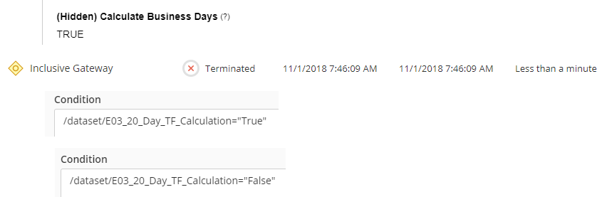

I have attempted both Inclusive and Exclusive gateways.  I have attempted conditions on both.  I have attempted one as the default path.  When I based it on a calculated field it always terminates.  I can use the same gateway on a field that does not use a calculated field and it works fine.

Gateway: /dataset/DeadlineCalculateCount="True"

For the gateway I have tried True/False; TRUE/FALSE; and 1/0 combinations.

Thanks for the advice but it is still failing for me.  The field I am basing it off of does indeed show True.  I have more than just the outflow condition using this field.  I also use it for show/hide rules.

True/False in the original field works fine for show/hide rules I just can't make the gateway decision work off it.
I recreated what you did - just a number field and the field with the formula.  I can't even make the gateway work with this.  It still terminates.
I am working in Professional Version 10.2.1.246

I needed to use all caps "TRUE" and "FALSE"
