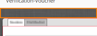

I have a form where making it as compact as possible on the screen is critical and as a result, I am having to use CSS to minimize most margins & padding.  The last thing I need to make really small or remove is the canvas background.  When the form loads on the screen, it appears to have 20-30 px dedicated to showing the top of the background/canvas that I would like to remove (shown in the orange box below).
The problem is that I cannot find a way to remove that as it is not part of the bod,y but instead appears to be part something built via JS.  Does anyone know how to resize/remove the top portion of the background/canvas in a form?

The customer wants all of the info shown without having to scroll so I am having to utilize all monitor real estate I can to make it work.  I am just trying to get rid of the empty space that is shown above a form in the orange box.  This is the space that shows the background color/pattern but does not contain anything in the actual form.

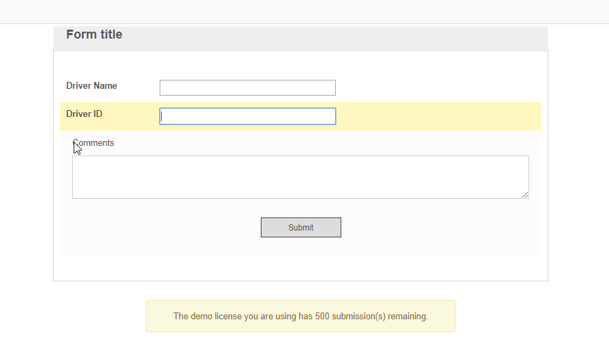

Hi Beau
Hope this help's, It takes like a split second to move up.
$('#cf-formtitle').css({marginTop: '-=38px'});
move form.png (9.59 KB)
