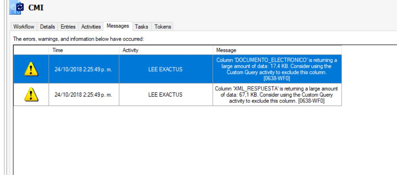

We need to read from a SQL table a value that exceeds 100 characters. By including the Query Data activity in the workflow and trying to read that column, we get the error: "Colum ELECTRONIC DOCUMENT is returning to a large amount of data Consider using the Custom Quey activity to exclude this colum [0638-WF0]"
Any suggestions on how to solve this problem?
replied on October 29, 2018
This is not an error, it's a warning. If you don't need that column, exclude it from your query. If you do need it, then you can ignore the warning.
I can not ignore the warning, I need to read the whole column, they are around 9056 characters, however, it only brings 3698 characters with any of the indicated activities
replied on March 19, 2019
I am receiving the same error, could you find a solution to this problem?
replied on March 25, 2019
Again, this is a warning, not an error. The entire data is returned. Token values are truncated to 3700 characters when tracked to the database, so you may not be able to see the entire value in the instance details. However, the full value is used at runtime when other activities interact with the token.

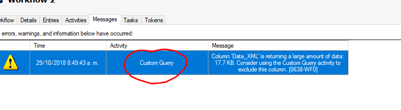

Hola David,
Gracias por la ayuda, he cambiado de actividad sin embargo el mensaje sigue siendo el mismo;
Alguna idea?
