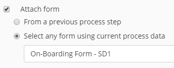

In Forms process, I have configured Email activity as follows
This activity is working fine by sending the email to the intended recipient with the right form attached.  However, the file name of the attachment is wrong as shown below

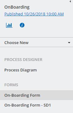

The attachment name should be On-Boarding Form – SD1
The “On-Boarding Form – SD1” is a copy of the main form named On-Boarding Form with some fields removed.
Any idea how the correct form is attached to the email but with the wrong file name.

Is your entire Form Process called "On-Board Form"?
replied on October 26, 2018
Hi Lidija
The form process is called "OnBoarding"
Thanks

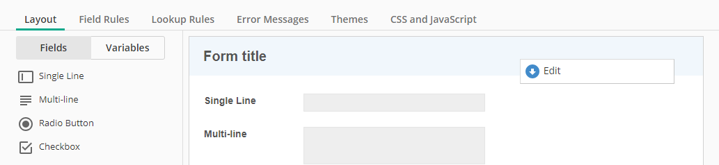

replied on March 4, 2019
Check on the Form title for the On-Boarding Form - SD1. If you open up the form, look at the top title in the gray area. Since you made the first form"On-Boarding Form", the Form title defaulted to that name as well. Since you copied the second form from the first, then renamed it, I'd bet the form title never got renamed.
