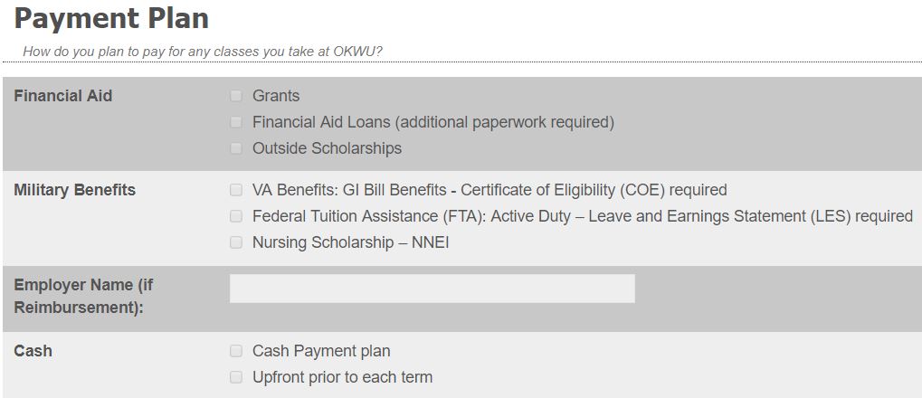

I am sure that many of us have faced this problem when working with a Workflow that is started by a Form:
If the Form has a checkbox or any kind of multiple values, how do you format the email (for example) to include just selected tokens?
For example:
Now if you have an output email that asks for all selections, what do you do?
Currently, the formatting can look something like this (because all variables are included):
From LF Forms || Source: || Payment Plan selection(s): (FA) Grants: False Loans: True Ouside Schp: False ( per  from ) || (VA)  GI: False () Other VA: False (Tuition Assistance) ||    || Employer reim:  ( per )  || (Cash) Payment Plan: False Upfront: False
Opt out of books? Yes, opt out.
Lots of extra things that may not be filled out for this particular case that are simply cluttering this note!
I could use Parallel Conditions to check selections and then tokens from there - great but since you have to have groupings then you will still have extra characters. Like the || for dividers, well if there is nothing in that grouping should the divider exist?
Anyone else that has a solution to something like this?

If you retrieve the Checkbox as a whole, it should only return the values that have been selected, in which case you just add the indexing and a separator like Chris said.
Are you saying you only want the selected values, or that you want all of the values regardless of whether or not they were selected?
