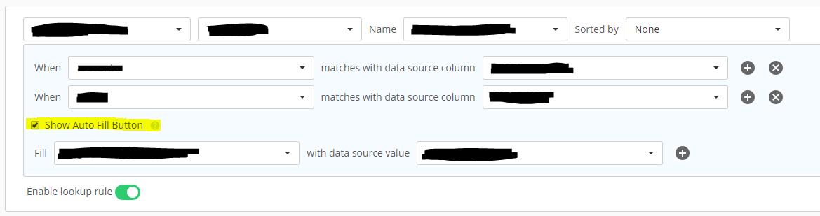

You can easily test this by checking the "Show Auto Fill Button" option on the lookup rule; this will give you the ability to manually run the lookup.

That option does not exist in my version of Laserfiche Forms. Although the button does appear on my Form when I preview it. Is there a way I can change the location of this button? It seems to place it in a weird location.

Which version are you running? I’m sure you could relocate it with CSS, but I don’t have any sample code for that since I’ve always had it run automatically.
Although I would recommend upgrading Forms, another option is to use JavaScript/JQuery to hide the button and click it automatically any time one of the lookup fields changes.
