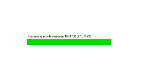

We have large conversion workflows that run.  At the end of a workflow we get a warning but the Processing activity message screen (or any of the history) never seems to load.  It just sits near the end of any of the workflows.
Is there a spot in the Workflow tables in SQL where I can look to figure out what the error message is?
I have checked the error log in the Workflow Admin Console and cannot seem to correlate anything there to the workflow I want to look at.

If the instance is complete (with warnings or terminated with an error), you can look in the search_error_log table using the query below (you can get the instance ID from the search results in the Designer:
select * from search_error_log
where search_id in
(select search_id
	from search_instance_log
	where instance_id = 'INSTANCE ID GOES HERE')
If the workflow is still running, then the same query works, but against the search_error and search_instance tables instead.
If the workflow terminated with errors, the errors would also be available in the activity errors.log in the WF Admin Console. Depending on when they occurred, the log may have rolled over, so you may have to check a couple of the older logs. The date range each log covers is in their name.
replied on October 18, 2018
Did this instance complete with warnings or terminate with an error? (it's unlikely it will finish loading since it's trying to list 1.5 million activities)
replied on October 19, 2018
Yes, it completed.  I know its a lot and don't really expect all of it I'd just like to see what the warning message was.  Figure that might be in a table somewhere.  I took a chance and kicked off the workflow again and the error happened pretty quick and was able to see it.
