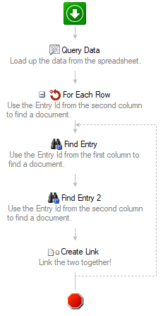

What you're looking for is fairly straightforward in Workflow.
The trickiest piece will be creating the data source.

For the Data source, you should be able to use the attached Workflow (rename .txt to .wfi ) to read the spreadsheet and query the data. There are two points to be aware of:

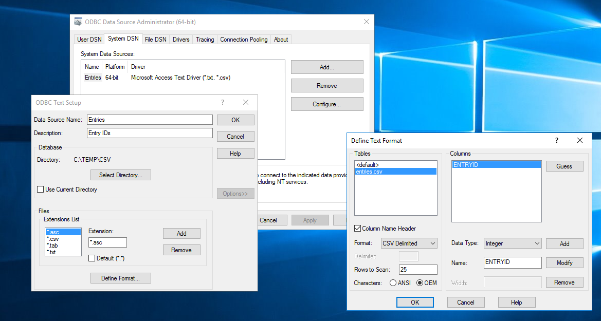

- Download / install the Access Database Engine 2016 - This will install the ODBC drivers to read csv / xlsx files (available here: https://www.microsoft.com/en-ca/download/details.aspx?id=54920 )
- Create an ODBC entry - see sample:

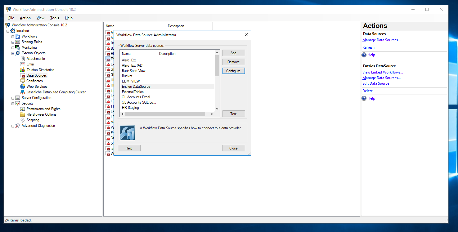

- Create a Workflow Data source entry for that ODBC entry within the Workflow Administration console (see sample)

- Import the attached Workflow > Map it to your newly created Data source and run it against a CSV file you've created - You may modify the name / path of the csv file in the Token / Query Data activities.
If it works, it should save the csv file to the file system and read the rows. Once you get to this point, you can now include the steps that Devin listed above.
