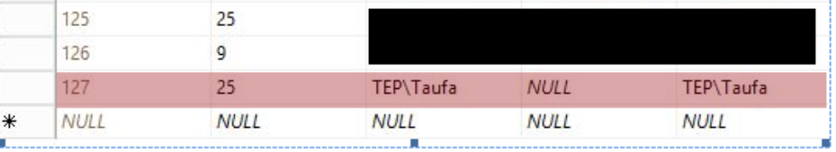

We have observed that under dbo.cf_user_snapshot, we had duplicate users.
It looks like, because we changed the database (added the email manually), Laserfiche try to correct the database by add the user again and again (without the email).

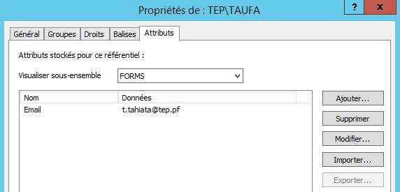

Hi all, thank you for your returns.
I asked my customer to add the attribute [FORMS]Email.
This is the database dbo.cf_user_snapshot before.
Then he add the email
then, under the Forms, he synchronized the users
The email is still missing

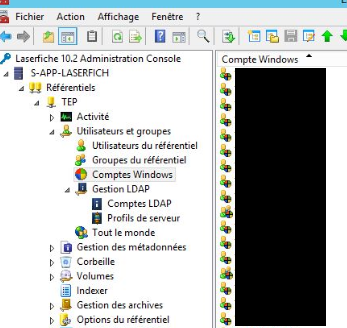

replied on October 12, 2018
Did you check if it is a Windows Account or a Repository User? If it is a Windows Account, then the email address attribute in AD needs to be populated so it is brought in.

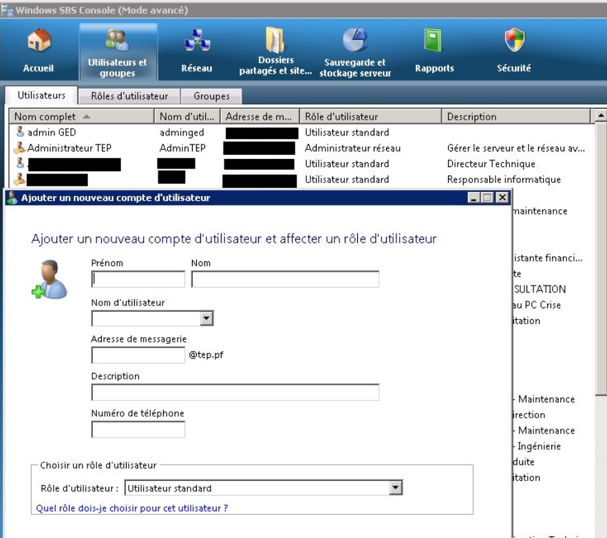

replied on October 15, 2018
Hi all.
My customer use Active Directory (Windows SBS Console) to create a new window's session.
But under Laserfiche, he used Windows' Account until use LDAP's account
Is it our error?
Thanks in advance.
