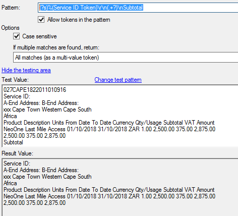

I would like to extract the text between the anchors, the text length is variable. I am not able to anchor the string to the Subtotal found at the start of the new line.
My current Regex. (%Service ID Token)([^_]+.\r\nSubtotal\s?[^_]+.)

Hi Christo,
Does this give you what you are looking for?
(?s)%(Service ID Token)\r\n(.+?)\nSubtotal
~ Andrew
replied on October 11, 2018
Andrew Pappas Thanks for the help, works 100%
