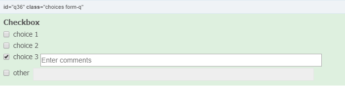

I have a Checkbox with 5 total options, but 2 of them, if checked, need a text box to provide additional information.  You can add 1 of this style checkbox using the "Other" option of the Checkbox configuration, but how would you add 2 "Other" style checkboxes to the same checkbox field?

Hi Bert,
You could tinker around with this:
$(".choices").change(function () {
    if ($("input[id^=Field36-2]").is(':checked')) {
        $("input[id^=Field36-2]").next("label").after(" " + "<input id='acomment' placeholder='Enter comments' type='text' />");
        $("#acomment").addClass("singleline cf-large");
    } else {
        $("#acomment").remove();

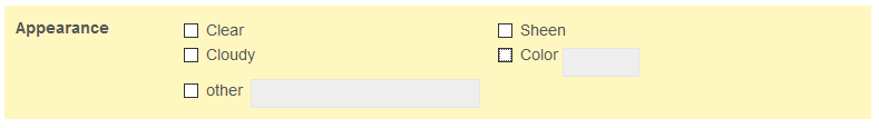

Thank you Andrew
You pointed me in the right direction and below is the JavaScript that I ended up using
  $("input[id^=Field13-3]").next("label").after(" " + "<input id='acolor' type='text' />");
  $("#acolor").addClass("singleline cf-small");
  $("#acolor").attr("readonly",true);
  $(".appearancechoice").change(function () {
    if ($("input[id^=Field13-3]").is(':checked')) {
        $("#acolor").attr("readonly",false);
    } else {
