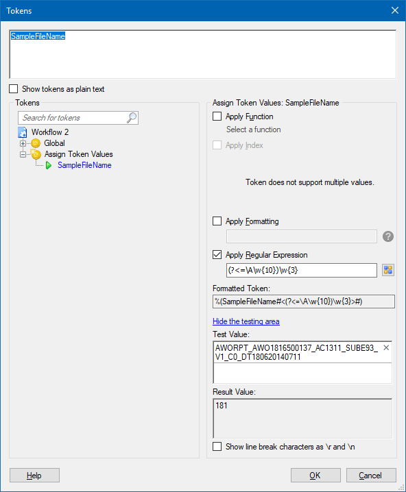

Ok, here are a couple of options, depending on other variables.
All of these require you to use a regular expression in the Token Dialog when you assign the token.
This one works purely on position. Basically "get me the first three of any character after the first ten"
(?<=\A\w{10})\w{3}
This one assumes that the first part of the string is a consistent prefix. "Get me the first three of any character after the prefix AWORPT_AWO"
(?<=AWORPT_AWO)\w{3}
If you need to, we can assert that the three characters we grab are in fact numbers:
(?<=AWORPT_AWO)\d{3}

replied on October 4, 2018
That worked great!
Thanks so much for the help.
