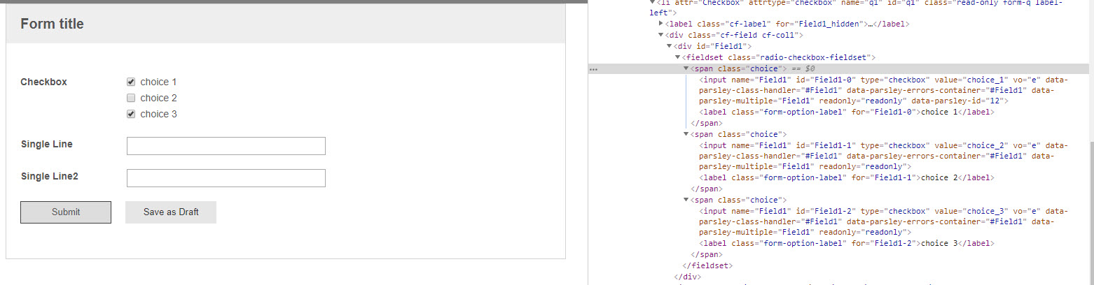

I've verified in the debugger console that the element is flagged readonly, but in Forms I can still interact with the checkbox. Any advise?

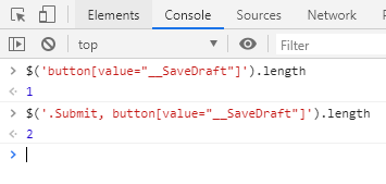

replied on May 16, 2019
Which version of Forms are you running? My suggestion would be to right-click and inspect the actual save button on the pop up.
This is the button that you're targeting and in the version I'm running it has the value used in the JQuery selector.
Testing in the browser console will also confirm whether or not the selectors are functioning.
Forms 10.3.1.635
Here is the inspect:
Interesting. It looks like the selector is fine, so something else must be going wrong.
