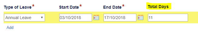

We have a client who has come across this on a specific form where Javascript is used to calculate the days as per below:
Example using Chrome:

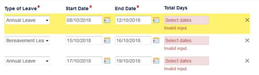

But, when using Mozilla, the client sees the following occurring where the calculations are not triggering?
I will be more than happy to provide the Script, but just wanted to see if anyone has experienced this before?

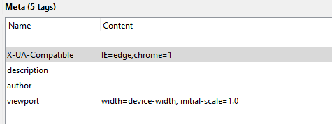

We also checked and can confirm this is what we see within the Form Certificate General TAB under Mozilla?
The site is using SSL certificate and it is also valid.
