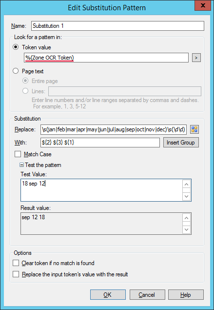

You can use the Substitution process to fix things up.
Replace Regex: (\d\d)\s(jan|feb|mar|apr|may|jun|jul|aug|sep|oct|nov|dec)\s(\d\d)
With: ${2} ${3} ${1}
This results in sep 12 18 which Quick Fields will be able to turn into a valid date. You might need to tweak that regex to more closely fit your dates. I just threw it together off the top of my head, so I don't know if the numbers in your dates can be one digit.
replied on October 1, 2018
Thanks, worked like a charm! I'll have to remember this if I come across this again.
