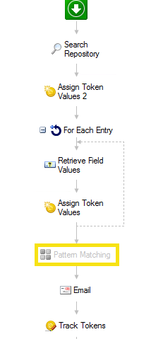

Im trying to see if there is a way to use the Multi-Value token function for Sorting to work on Date values.  Is there any way to apply this?
The output should be ordered by Date Ascending.
EDIT:  I am also binding the Document ID with the row as well:

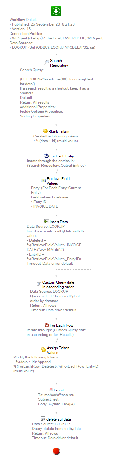

Hi Chase,
I received the same error when trying to retrieve field values from multiple documents.
As a workaround to this, I wrote those values to a sql table and afterward query them in order statement.
I know that this is not the neatiest way but it worked for me both for Date + Entry ID.
Hope that this help you!

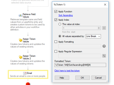

Hello Chase,
I created a workflow and have been able to sort the date in ascending order.
Below is my workflow;

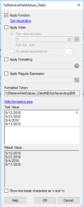

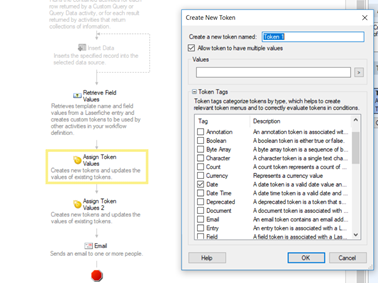

First my field type is set to Date.
In workflow, my Assign Token, ("Token Tags") is set to Date
Apply Function: Sort Ascending
Apply index: All values separated by mail
I used the email activity to test the results.
replied on September 26, 2018
I think the issue may just be that he is expecting the "Testing Area" in the token dialog to reflect the sorting. It does not. I think the Testing Area is only meant to be used with the Regular Expressions. The sorting should work when you actually test the process though, as the other posters are saying.

Thanks Scott,  Yes when I'm mostly looking at the result,  I'm actually looking at the token output presented in the Workflow being run,
I removed the Document IDs and set the Date Token from String to Date and tested with no success still even through email as you have shown above.
But even so,  I need the Document ID linked with.  Once it is reordered, I would lose which document to refer to.

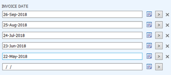

Also my workflow is not grabbing a multi-value metadata field, these dates are coming from individual documents:

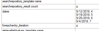

The behavior is correct. By appending the entry ID, you no longer have dates, you have strings and they're ordered alphabetically. "9/" is the same in both, but "2" is before "4", so at that point "9/25/2018, 6" is sorted before "9/4/2018, 7".
Scott's suggestion should work for dates, but be aware that alphabetically "9/4/2018, 16" will still come before "9/4/2018, 7".
