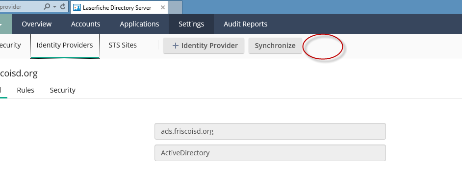

Usually we can see the last time an AD sync occurred on the Laserfiche Directory Server Settings/Identity Providers page. We typically have an "i" graphic we can click on that shows this info. For some reason, it seems Laserfiche Directory server sometimes does not show that "i" graphic so we can not determine the last datetime the AD sync occurred. See screenshot below with red oval... that's usually where the "i" graphic is located. Can anyone shed light as to why this might be happening? Ensuring our AD sync is critical for us when we have questions from users on security access.

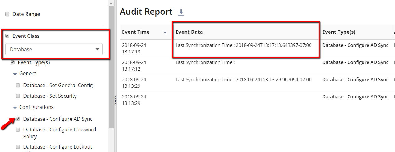

For now, you can use the audit reports section to check for the last AD sync time. The simplest way is to filter on the Event Type, Database - Configure AD Sync. It will show you the last synchronization time under event data:

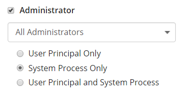

If you get back too many results, you can also filter to only show system processes (which will exclude events like manually clicking synchronize or editing rules):
The icon won't appear if there are not any synchronization events (e.g., a new database), but it sounds like you've used it before, so I have a few questions/troubleshooting steps:

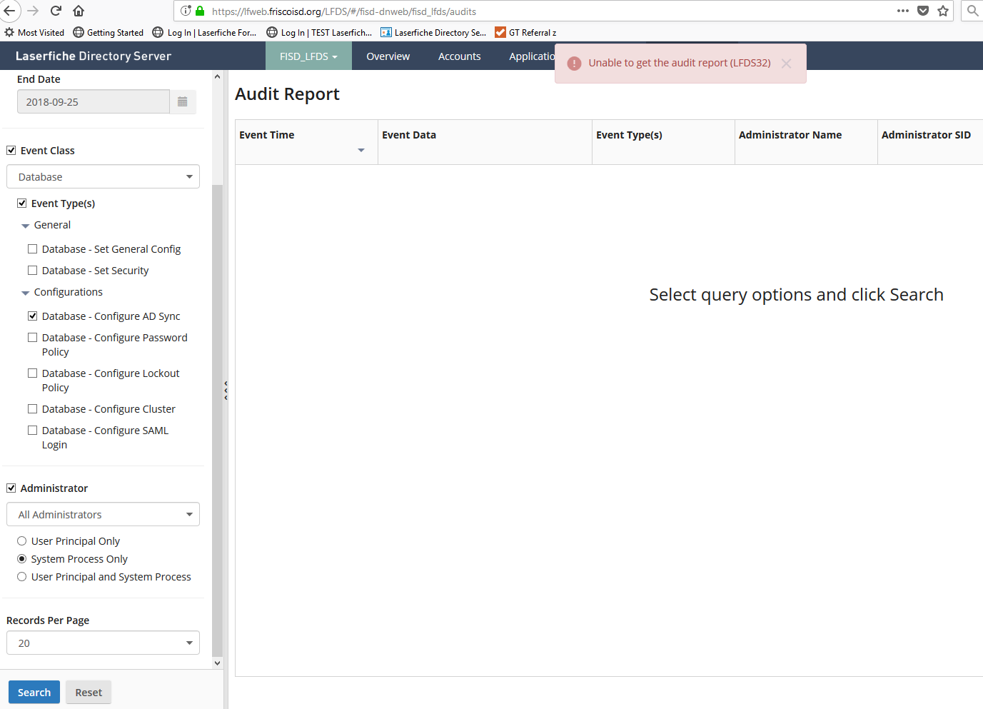

Thanks for the response. I attempted to run the audit report and got an error (see screenshot below). We upgraded LFDS a few months ago. When we force a sync, it can take well over an hour and seems to essentially consume our system resources to where forms do not process. My understanding is that the sync is not incremental but a full sync of all AD groups each time. I manually synced the other day but it did not result in the "i" reappearing :-0. However, we have seen it disappear for a few days and the reappear again.
