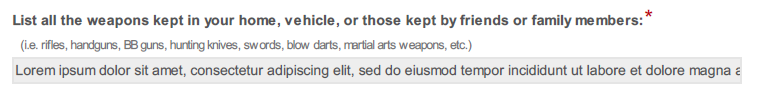

We have a rather lengthy form, ~50 pages.   When it is saved into the repository as a PDF,  single line inputs are shown as a gray input area and the text is cutoff.

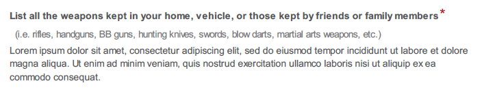

However creating a small test form, single line inputs display all the text when saved as a PDF and not on a gray line:
Why the difference?
The two single lines are setup identical on each form.
My test form mimics the lengthy form, javascript, css, sections, pagination, , signature fields, etc.  (No javascript ,css  or field rule is applied to either of the single line inputs.)

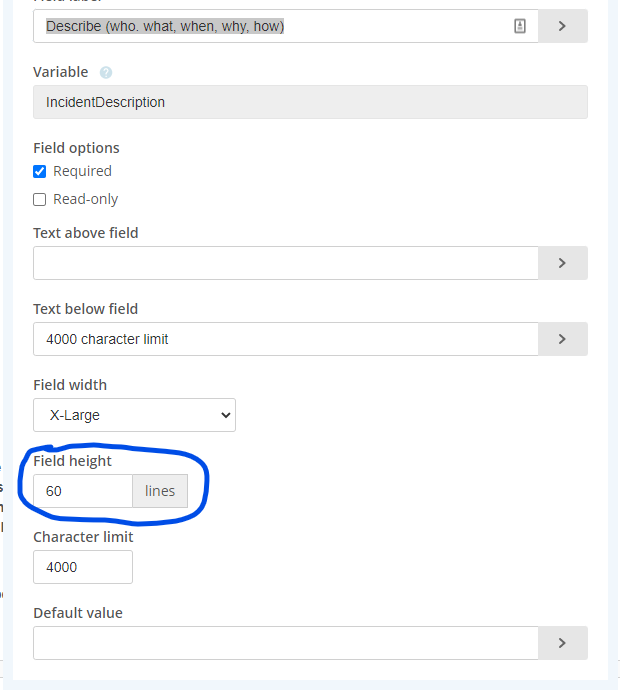

replied on August 15, 2022
Dear  Ziyan,
I was finally able to figure it out. I feel quite silly, to be honest.
I was setting the Field height limit to only 20 lines and didn't realize that it would cut off text.. The information was all there, but when it converts the form to PDF, it uses this to limit the number of lines and 20 was not enough for my 4000 character limit.
All fixed now!
