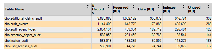

I was wondering why my Laserfiche Licensing database for Directory Server (10.3.0.11) was getting so large so I ran a report and noticed millions of records in the audit tables.  I don't even have that large of a deployment.  Is there a way from the Directory Server configuration to store less less audit data or purge some data?

We have a 10.3 customer also experiencing slowness and after checking the LFDS audit tables advised in this article their audit tables had grown to 80GB+ as the pruning operation had stopped working.
They have been able to confirm the table size is the issue by unchecking all LFDS Event logging options, however they still want to shrink or delete the audit table records to 1 or 2GB.

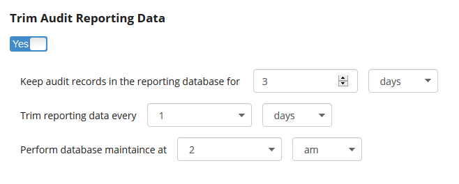

Hi Rob,
From the LFDS settings page, you can able the option to trim audit reporting data and then specify how much data to keep in the database, how often to trim, etc.

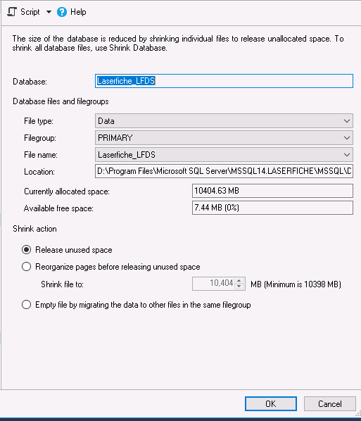

How long did you wait for deletion to happen? Did the number of rows in the database change?
The MDF file's size on disk will not shrink on its own, it needs to be shrunk from SQL Mgmt Studio (SQL will free up the disk as rows are deleted, but, because expansion operations tend to be expensive, it will not release the unused space).

Miruna,
We had this option enabled for almost a week no and see no changes.  Shrinking the MDF does not help either as shown below.  Also, when running an audit in LFDS, data dated back to when the initial installation still shows up.
