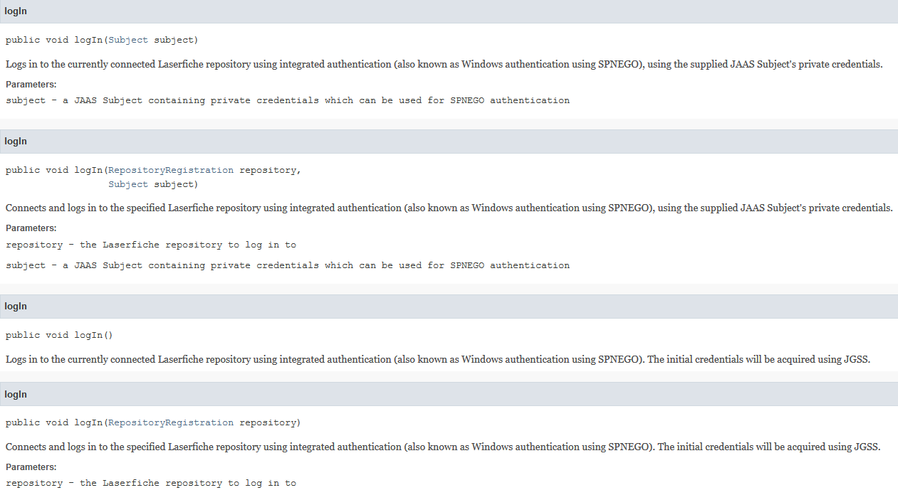

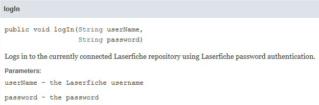

After the SDK is installed, in the "C:\Program Files\Laserfiche\SDK 10.2\Docs" folder, you will find jradocs.zip which contains the JRA dacumentation.  Open the "index.html" file and then you should be able to find what you need there.
Basically, the login override that you are using is for logging in with a LF User name and password.
To log in with Windows Authentication, you want to use one of the below overrides.
