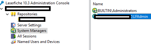

If you attempt to change a license in the Web Client Administration it prompts for a second authentication.
So I have to create this user right?
The location where I must create the user is under Local Users and Groups of the Laserfiche Server.
Then I must add this user to System Manager in the Laserfiche Administration Console.
Am I missing something here? What else do I need to do to setup a new user?

Laserfiche Privileges covers most aspects of the user creation process, but only Laserfiche System Managers can make modifications to the named user list. This does not NEED to be a user who is a local admin on the Lf Server machine and, in fact, if it's not a domain user it likely can't be found outside of that machine. Local admins on the Lf Server machine are in this group by default, but any domain user can be added to the System Manager group (your last step in the Lf Admin Console). But here's the thing, if you can add a user to the System Manager group... you are already a system manager. So you should just be able to use that same user account. The only difference is that the web client can't automatically make use of your current windows login, you just need to enter it in manually.

The local user I setup has not been added to any administrative groups, there is no domain to choose from leaving me with just local accounts, so it is just a new local account. I added the user to the System Manager group though so that it could be used to set licenses.
I am able to assign licenses when RPD directly into the server, I am trying to enable another user to assign licenses.

The only reason you need an additional account is if you cannot use an account that is a member of the local administrators group (windows) on the machine where the Lf Server is installed. This user has to be outside of repository security because these are server-wide operations at a level above that of the repository. For example, the same domain (windows) user would be used to do operations such as create or delete repositories - obviously that can't be a user within the repository itself as it might not even exist yet. Named user assignment is the one thing that is a bit ambiguous as you place it on a repository user (a repository action) but the act of actually assigning a named user slot to a specific repository/repository user is at the Lf Server level, hence needing to be a system manager.
My point above is that you don't NEED to create a separate (windows) user for it, if you've already got a local admin account (a domain account that is a member of the local admin group on the machine the Lf Server is installed on). You can just use that one if so. The difference is that the desktop admin can see that you are logged into Windows as that account and automatically use it, the web admin tools cannot so you get prompted to provide the credentials. Since you already showed that you are a system manager account by being able to add another account into the system manager list in the desktop administration console (picking up your credentials from your windows log-in), you shouldn't even need the other account and just use whatever account you were using to do that operation.

I can add users to the System Managers group as the built in Windows Administrator [.\Administrator] but I can't login as a System Manager with either the Windows Administrator or the LFAdmin account using the Web Client Administration site. I get the notification posted above that they are not system managers, when they are.
The reason I am creating the LFAdmin account is because I would not give out the local Windows Administrator account to a user just to add a license. I understand what your saying by adding another form of authentication, but it doesn't appear to be working in a non-domain environment. How do you handle your cloud customers?
