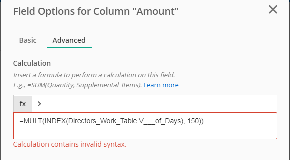

I am looking to calculate a currency amount based on a drop-down field field within a table.  I am getting a calculation error.  I have tried various things based on other posted questions/answers.  I do not know how to do calculations well.
Quantity of Days (Drop-down) * $150 = Amount (Currency $)
Please help! (below is my current formula)
replied on September 2, 2018
Hello Vanessa,
please try the following formula :
=MULT(INDEX(Directors_Work_Table.V__of_Days,ROW()),150)
it should work.
Maher.

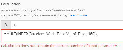

replied on August 31, 2018
Hi Lidija,
I tried what you posted above and verified that the drop-down field has numerical values assigned.  Now I get the following error (see image below).  Any suggestions?
Thank you,
Vanessa Huynh
replied on September 4, 2018 Show version history
=(MULT(INDEX(TableThatYouWantToPull.Column, RowNumber), 150)
Sorry!
Maher's way works well too because the "Row()" command will calculate the value for each row - this depends on where your calculation is at. If your output calculations are inline (same table) then you want to use the "ROW()", if you want the output of a specific row in a Number Field then you can use what I suggested. Play around with it to see what works best for your situation.
replied on September 5, 2018
Thank you Lidija!  I ended up using Matthew's formula because I had 25 rows to calculate. smiley
Great, you can mark his reply as the Answer to your question :) Thanks!
Vanessa, Try this:
=MULT(INDEX(Directors_Work_Table.V__of_Days, 150))
You had an extra closing parenthasis where you didn't need it it looks like.
If that doesn't help, make sure that the dropdown is a number or set the value (after it is selected) into a number field.
