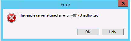

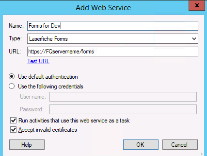

Our client has Workflow and Forms on 2 separate machines on the same domain. I am trying to add the Web service for Forms in the Laserfiche Administration Console (External Objects, Web Services). (I've tried it in the designer with same result)
When I attempt this, I get this error:
What exactly is trying to access what? I've tried changing credentials rather than "use default authentication" but am given the same results. Both workflow services along with the forms routing service are using the same domain service account. I saw some older posts about enabling anonymous authentication on the workflow websites so I've done that as well (even though I don't believe that is the answer).
I've also tried changing the URL to the external URL that users go to - getting the same error.

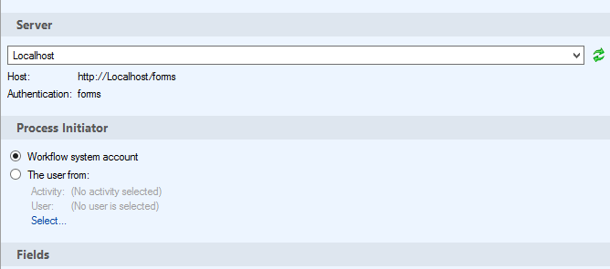

Yes I'm trying to invoke a BP in Workflow. I have to select the Forms server from the list, a list which is incorrect.
I had a BP and workflows internally on my system, and then exported and imported them into the clients Dev system. It brought the value of 'localhost' for the forms web service, which is incorrect as it's on a separate box. So trying to add a new one gives me the above issue. Hope this clarifies it for you. Thanks

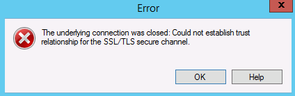

They were setup but have not used anything yet in the production. I have just tried it and I actually get a different error....happy monday to me...
This item is now resolved - I had to apply this KB on the prod Workflow server: https://support.laserfiche.com/kb/1013919/configuration-information-for-tls-1-2

Well I just tried something that I haven't yet....Rather than clicking the "Test URL" I just added it and tried to see if Workflow would see the BP's in Forms.....and it does.
So it appears that it will work even though the URL test fails....

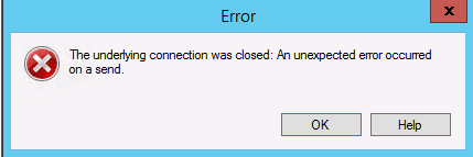

replied on August 27, 2018
I missed a screenshot, when I use the FQDN in the URL I get the following error:
