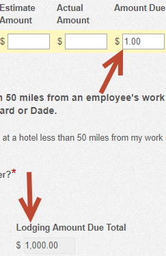

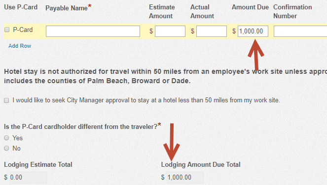

The issue is if I delete digits from this number (1,000) starting at the separator (,) then no change is detected.
If I select the ",000.00" from that field,
then press the delete button,
then click anywhere else,
the total is not updated:

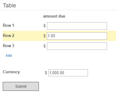

I create a fresh new form and the issue is perpetuating:
UPDATE 2:
I had a pretty good suggestion by @Susan Sloan to omit the separator value. I did this and the problem is still there.
UPDATE 3:
Make sure the total field is a currency field with the 'currency display' checked:
When the 'currency display' is not checked in the total field the error does not occur.
