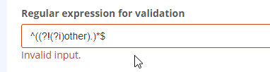

Theoretically you should be able to do something like this:
^((?!(?i)other).)*$
The (?i) tells the regex engine to ignore case, which would allow you to look out for all the combinations such as "Other", "other", or "oTHEr". However when I tested it in Forms, it won't accept that regex.
Failing that, you can use the pipe character to define an OR:
^((?!Other|other).)*$
replied on August 18, 2018 Show version history
Thanks.  I was trying to place my pipe in the wrong place.  I tried the first option to ignore case but the Regular expression for validation flags it as invalid input.
