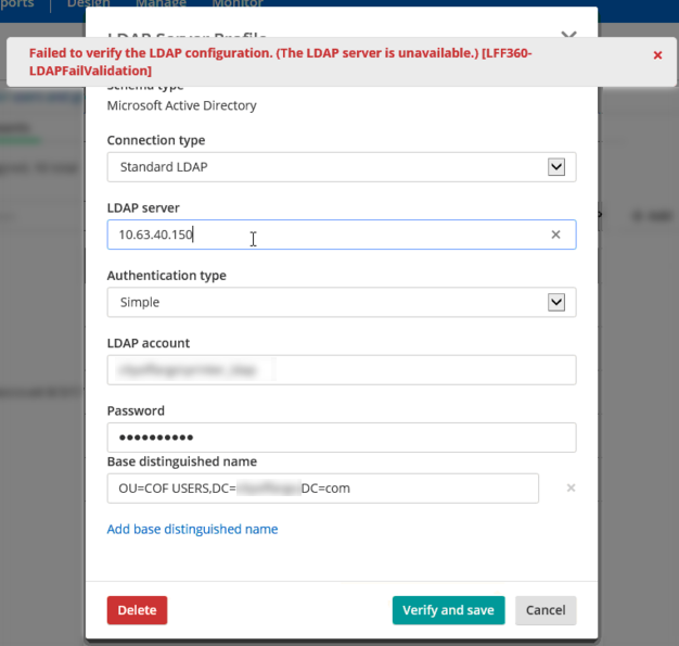

Hello,
We have a client that is trying to get the LDAP configured with Forms and is continuing to get the message "Failed to verify the LDAP configuration. (The LDAP server is unavailable,) [LFF360-LDAPFAILValidation]".
The user can ping the LDAP server no problem from the LF server and vice versa.
We referenced the Admin Guide as well, but still is not helping with this configuration.
https://www.laserfiche.com/support/webhelp/Laserfiche/10/en-US/administration/Default.htm#../Subsystems/Forms/Content/Security.htm
See screenshot below for the message.

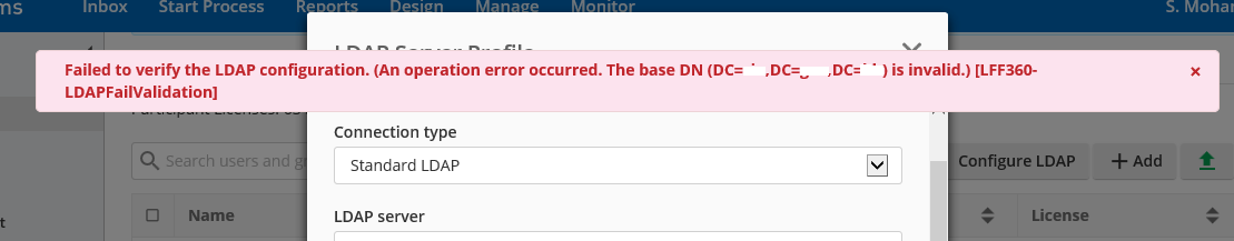

Hello
We also have the same ERROR with Laserfiche Forms Professional Version 10.3.1.635
but I got the Message Like That :
" Failed to verify the LDAP configuration. (An operation error occurred. The base DN (DC=***,DC=***,DC=***) is invalid.) [LFF360-LDAPFailValidation] "
and it was working well in Version 10.2
