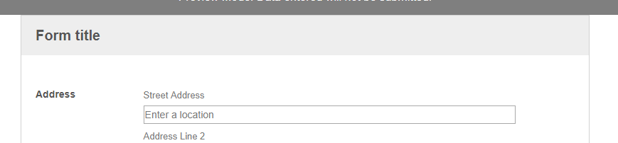

Initially you get this, which makes it look like it's working:

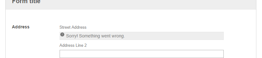

Then quite quickly, without even clicking in the box, you get this:
Then you are precluded from editing the field further.
It's as though it's attempting to load the API (we have rechecked the code and key are correct) but then fails to load it.

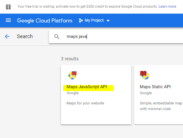

Basically, you need to ensure the that the correct Google API is enabled in your Google Cloud Platform console: https://console.cloud.google.com
Make sure this API is enabled:
As soon as I enabled this, the code from the other thread worked. Hopefully that's your issue too!
