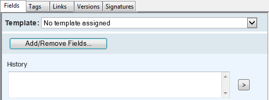

We can see this when we go into Laserfiche and pull up the metadata, where there is a blank in position 0 (see below).  As well, you can see the same entry in the propval table so you see we are working with the same data (also below).
You can see how Laserfiche handles the field and you notice that there is no value in the Storm_Mains field, just a number. Technically, it is showing the user position 0 (which is blank) and that there are 5 additional entries.
Here is an example of multiple entries with the same problem as well as my EntryID of 644091 that I have noted above. In each instance, position 0 being a blank has created a problem with how we see the data.

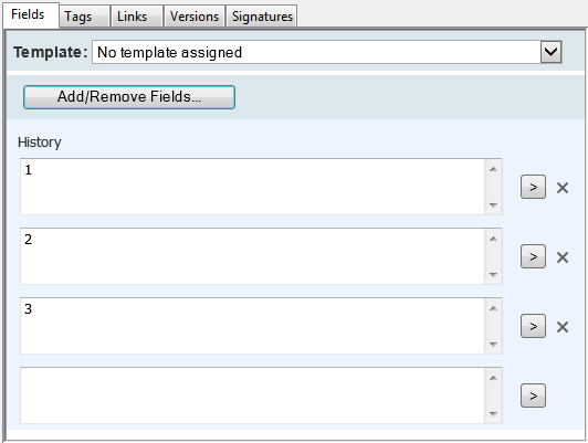

To test, I added a multi-value field to my document with no current value. In the database I confirmed that it is stored the same as in the original post.
Next, I ran some SDK code to update the field.
DocumentInfo doc = Document.GetDocumentInfo(entryId,session);
FieldValueCollection fvc = doc.GetFieldValues();
List<string> valueList = new List<string>();
valueList.Add("1");
valueList.Add("2");
valueList.Add("3");
object[] values = valueList.ToArray();
fvc.AppendValues(fieldName,values);
doc.SetFieldValues(fvc);
doc.Save();
And the end result is as expected; only my new values show up and the blank value has been removed.
valueList.Add("1");
valueList.Add("2");
valueList.Add("3");
doc.Save();
