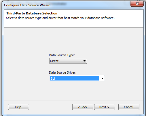

Ben,
If you are working with a SQL database, have you tried using a Direct configuration instead of ODBC?
With a Direct connection setup you would use @ parameters instead of ? parameter names, for example @P1, @P2, etc., and the data types might behave better.
In my experience you get much better results with a direct connection when dealing with SQL databases.

Typing number directly into the parameter works, but even creating a token and assigning it a number value does not work.  I will try direct connection next as recommended by Jason.

Hi Ben,
I think a direct connection will be more reliable (I get far fewer errors, false negatives, etc.) but I don't know that it will fix anything.
I still think it is a good thing to change, but I also think Miruna's suggestion of tracking the token is an important step in narrowing down the source of the problem.
