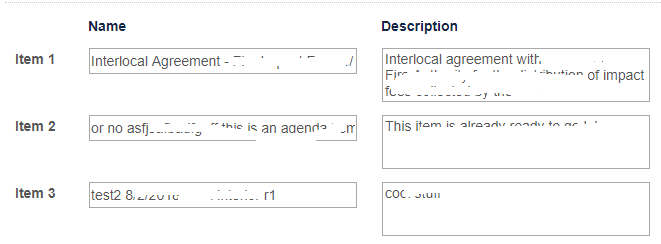

Basically,  i have a form that i am reordering the rows of, as I reorder the rows I update the table label to show the move. however... this is not saved after you "submit" and reload the form variables on the next page...
now i know that i can use JS to add a row, then delete a row as a means to update the tables but it feels like a really messy and inelegant way to solve the issue... we should be able to call the same updates that are happening in that process.
$(".testTable tr").each(function(){
        $(this).children("td").first().html( "Item "+($(this).index()+1) );
Next form page, same form variable but reverted order of index rows

replied on August 7, 2018 • Show version history
I think rather than trying to rearrange the actual DOM elements, you would be better off moving the data around since everything on the back end is tied to the Field identifiers.
For example, if you move Field1(1) down and move Field1(2) up, they are still the same objects storing the same values so really you are just changing the display, not the data order.
To change the order of the data in a way that will hold from one step to the next, you should do something more like the following:
Set two JavaScript variables for each column, store the current values of those fields, then assign the values back to the new fields.
Hmmm, that is most definitely another way of doing it, with an if statement to make sure the top/bottom cannot move in the "wrong" direction.  think i will give this a try as at least a working solution instead of using the "add" "delete" option we have now.
because the thing is... using my current method, if i Add a row and then delete the row, the data does save in the correct order.
