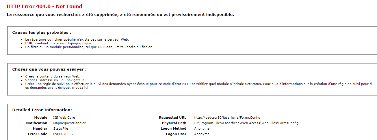

After upgrading Laserfiche from 10 to 10.2.1, all web component stopped working.
i suppose that i missed something on the IIS configuration?
the error when launching forms, audit trail webadmin is the same (see the picture )
thanks in advance
Hanane.
replied on August 1, 2018
That url - /laserfiche/FormsConfig/ - is not expected to point to anything.  The /laserfiche will map to the Web Client, but it doesn't have a /FormsConfig subdirectory.  Can you go to just /laserfiche?

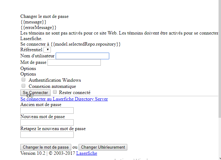

replied on August 2, 2018
and when i try to go to webaccess i get this
I'm talking about the "Requested URL" in the original screenshot, which is not expected to be a valid URL.  It's possible that doesn't match what is in the browser location bar - since there's no reason for you to try to load that URL - and if not that would be interesting to know.  The new screenshot makes it look like the aspx page loaded ok, but none of the static resources (js and css) did.  These combined make it seem like something is possibly not right with URL forwarding, and the addition of /FormsConfig would lead me to suspect something with that product.
I'm suggesting the possibility that Forms changed some IIS settings that ended up breaking all of the other applications, but it's not really more than speculation.
In the first screenshot in this thread: what URL did the browser try to load?  As I said, the error message indicates it was processing a URL under the Web Access application that is not supposed to have content, so that's only problematic if the browser was trying to load a different URL than the one indicated in the 404 response.
The second screenshot shows that you can get to Web Access, though of course it's not working properly.  What errors show up in the F12 developer tools or console?  I'd guess it's not loading some resources - what errors show up in the network tab?
