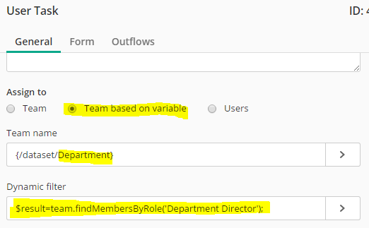

But more importantly to me, is I'd like to assign task to specific Role (or user) inside a team.  So a starting form asks Department and I'd like to Assign Task to Team based on Department but to the Role "Department Director".
EDIT: In the process diagram, user task I see the Filter option when you select assign to team and that you can use $result=team.findMembersByRole('Department Director') but when you click over to use Assign to Team based on variable you lose that filter and it becomes a dynamic filter that this doesn't work for any longer unless the syntax has changed maybe?  This (below) did not work:

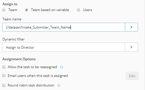

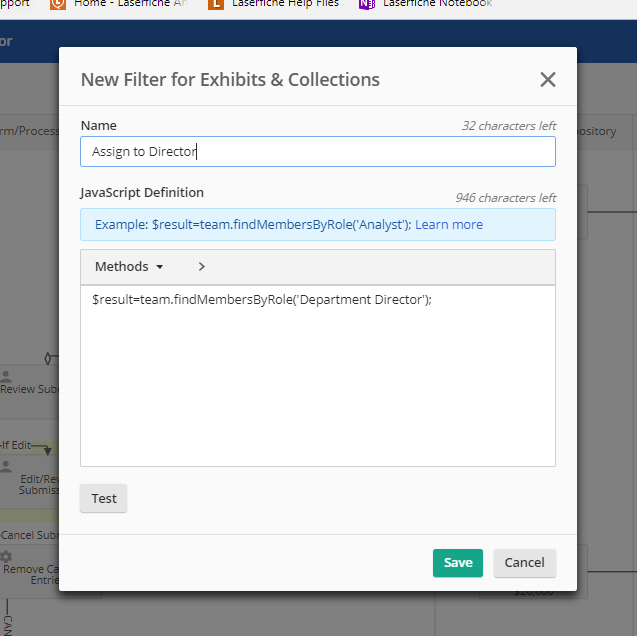

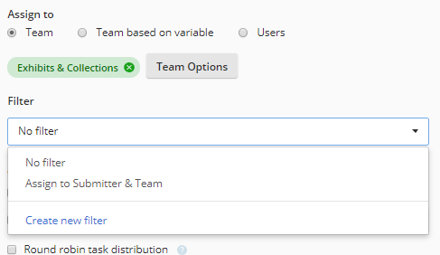

You're halfway there. As I mentioned in the novel I just wrote in reply, this part wasn't really explained anywhere. In order to use the filters on the "Team based on variable" you have to first select "Team". Then select the team that the filter will be applied to. In the Filter Drop down select "Create New Filter". Name the filter and copy the name to your clipboard. Use the $result=team.findMembersByRole('Department Director'); inside the definition (You can test it to make sure that it will return results) and save it. Now that it's saved you can switch back over to "Team based on variable" and you would then paste the filter name into the Dynamic Filter box. This will then allow you the use the filter that you've just created. Note that the filters are specific to the Team itself, so if there are multiple teams that could be resolved from your variable, you'll have to follow to above steps to create the filters for each team. You can reuse the same name on filters that are the same, and if you need to use different filters on the same Team Assignment, that's when you would use a second variable to resolve the Filter Name just the same way you did for the Team Name.
