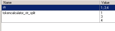

I was using the SPLIT function from the Token Dialog :
With a token str = "1;;3;4" and another token str_split = SPLIT(%(str), ";" ), I have the following result

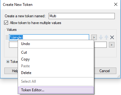

I see now that you are using the Token Calculator to create the split.  Not sure why that is dropping the blank/empty item, but you can just use the regular token editor by adding the token and then right clicking the token name and selecting "Token Editor..." and you will get the above dialog
replied on July 24, 2018
Frederic's screenshot above seems to imply he's using Token Calculator, which does exhibit the behavior he's describing. It looks to be a bug in the activity (reference ID #159689). The Token Dialog/Editor behavior is correct.
Hi Miruna,
You're right : The problem occurs with the Token Calculator and not the Token Editor.
