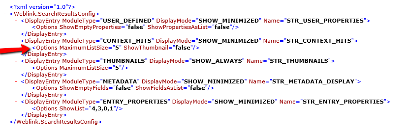

In WebLink10 and WebLink10.1, there a different method to increase the number of search hits.
  1. Under Install folder\Laserfiche\WebLink\WebLink\Web Files, edit file SearchResultsSettings.xml
  2. For ModuleType = CONTEXT_HITS, increase the MaximumListSIze
The default list size is 5. There is no upper limit to the list size.
     3. Clear browser cache and reset iis. The settings are reflected.
