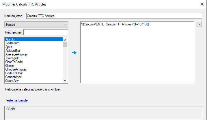

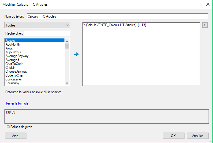

I'm trying to get a value from a multiplication but, during my save, I have something strange.
If my function is : var*1.13 my result isn't save in my database
but if my function is : var*(1+13/100) my result is saving in my database.
The first line is for *1.13, the second one is for *(1+13/100)

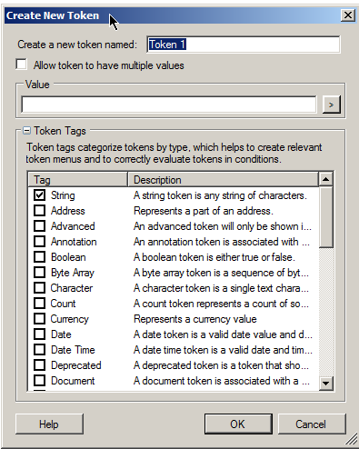

replied on July 19, 2018
My guess is it's a conversion error with value types (all too common with SQL) but I don't see how that would happen unless your token or SQL table value types were changed around in the middle of your troubleshooting. I've had to specify token types on the Workflow side to get numbers to feed into SQL tables, and I've seen it do odd things where it works one way, but not another.

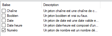

Hi all,
thank you for your helps.
This is my printscreen for the result (my token = 123)
See? The results are the same.
@████████, my token is Decimal

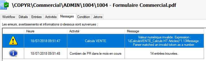

Can you check the instance details when you run the activity that multiplies by 1.13? Are there any warnings or errors?
replied on July 25, 2018
Hi Miruna,
Yes I have a Warning (Invalid numeric value)
replied on July 26, 2018
Ok, that matches what I was seeing. This is a bug with Workflow on operating systems in languages other than English. Reference ID # 159686.
