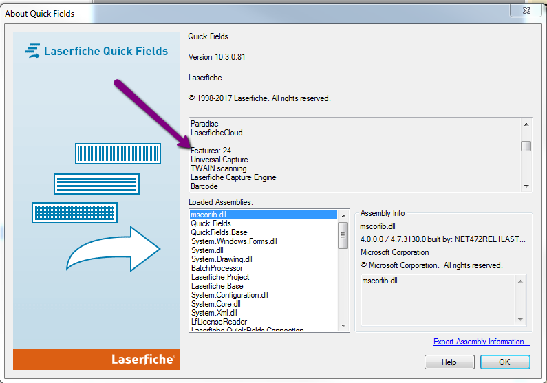

replied on July 17, 2018
If you look in the About dialog in Quick Fields on that machine, does it list Quick Fields Agent as one of the features?

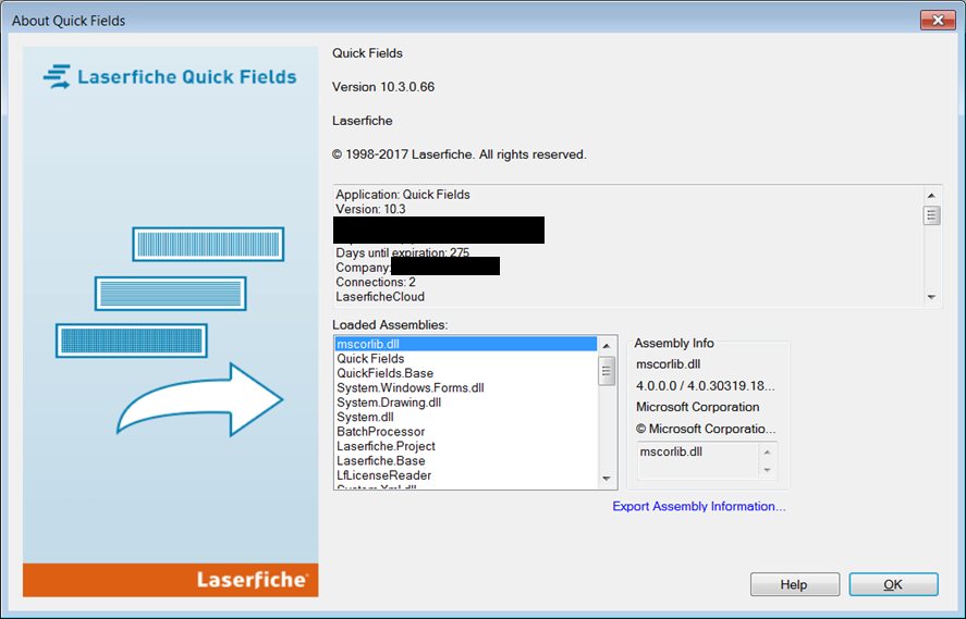

replied on July 30, 2018
I don't see QF Agent Listed.  I've attached a screenshot for review.
Your screenshot is not showing the Features section.
