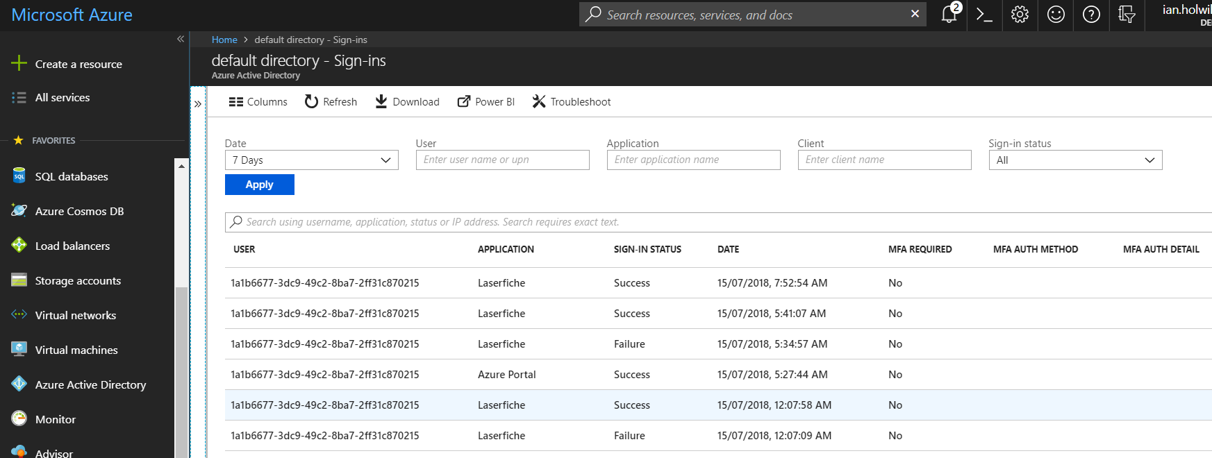

We now have a further issue.  While we can see in the Azure logs (see attached screenshot) that Directory Server is successfully authenticating a user for Laserfiche, access is still denied.  I believe this is because SAML accounts have not been successfully synchronised from Azure AD to Directory Server and therefore are not available as accounts to be given access rights in Laserfiche applications.

Access denied happens after clicking on the SAML(Azure AD) logon button and after the successful Azure authentication event in the Azure logs, it then displays the standard Laserfiche login page, because access has been denied (I am assuming).

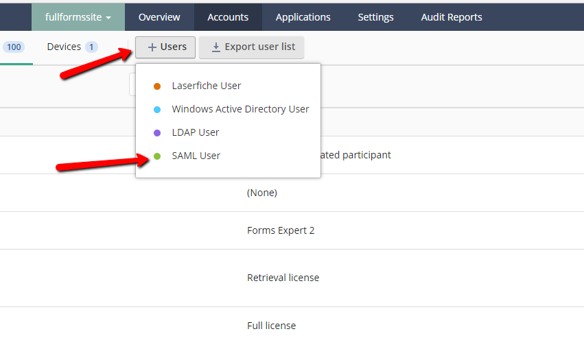

Hi Ian,
Could you please check if you have set correct access for this user in Azure portal?
https://docs.microsoft.com/en-us/azure/active-directory/application-access-assignment-how-to-add-assignment
You should be able to add SAML user to LFDS manually, either one by one or by CSV import.
