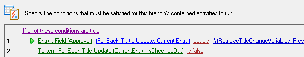

Mark,
The documents that don't update may be locked/checked out.  I ran into something similar with a metadata update workflow recently. In my For Each loop I set the condition you see below to make sure I didn't process any checked out documents.
This would make sense as to why you are not getting the same number processed, as returned by your search.

replied on July 12, 2018
This entire process is run at night, so no users are in the system. Additionally, when I do a manual search in LF, the doc ID (entry ID) that is in the SQL table comes back not found. Therefore, it appears that the SQL statement that I included is returning an entry ID, but then somehow that entry ID does not exist. I don't know how I can be pulling this directly out of LF and the ID doesn't exist.
