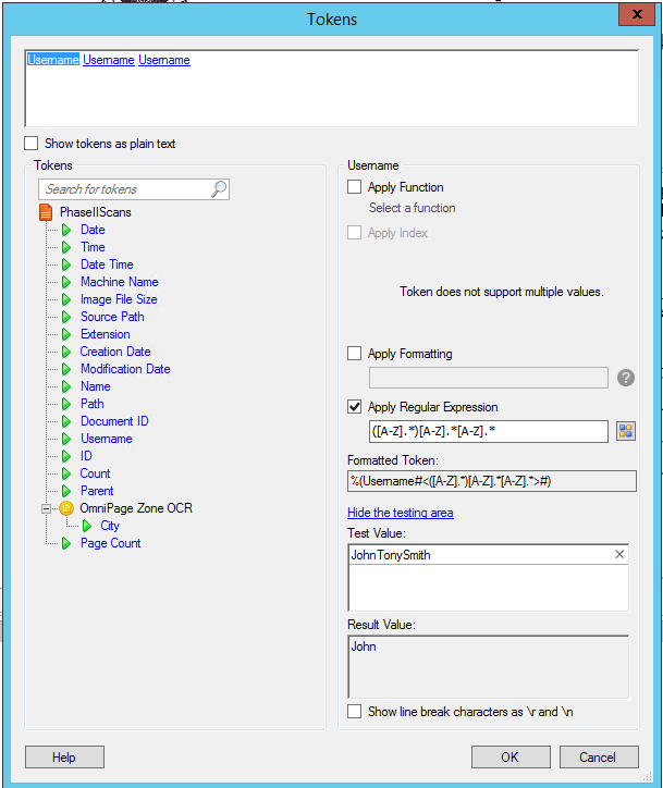

I think you can accomplish this with a series of regular expressions.  At least if the strings  have a consistent number of words.  The expressions would look like this, to break it down.  Then you could put it back together with the spaces.
([A-Z].*)[A-Z].*[A-Z].*
[A-Z].*([A-Z].*)[A-Z].*
[A-Z].*[A-Z].*([A-Z].*)

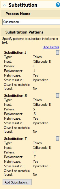

If you have substitution, you can create a substitution rule for each letter A-Z.  So "A" is replaced with " A", etc.  Mack sure to check the box to match case and the box to replace the input with the result.
In my sample, I just do the 3 letters of your sample name
The data is in a barcode that is read into token %(Barcode 1) by my QF session.  Then after I run the substitution on that token, to use the token data, apply a trim function.
