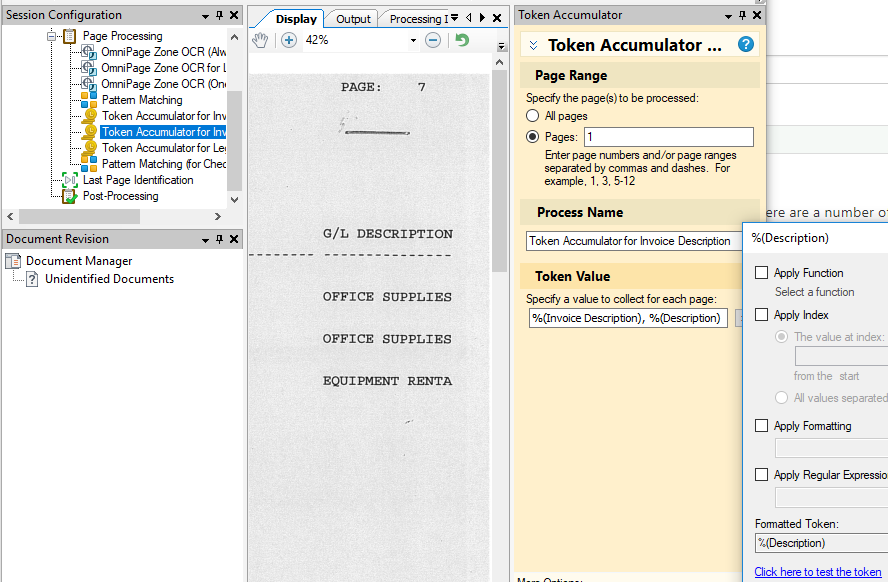

Quick Fields auto corrections possible?
asked on July 5, 2018
Is there a way to get Quick Fields auto-correct specific common errors in the target fields?

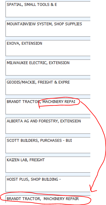

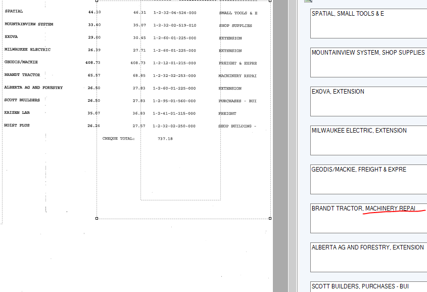

For instance, I have it picking up words in a column to fill in a multi-value field.  There are a number of very common words it will find, however, some of those common words get cut off and I have to manually correct them to ensure searchability.

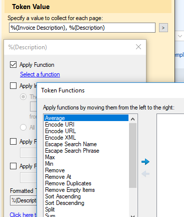

Can we use the Token Editor (or something) to cause an auto correct?
  • If it finds EQUIPMENT RENTA, then auto correct to EQUIPMENT RENTAL
  • If it finds MACHINERY REPAI, then auto correct to MACHINERY REPAIR
  • If it finds SHARED COMMUNIC, then auto correct to SHARED COMMUNICATIONS
  • etc,
Is so, how would I set this up for numerous corrections?
Thanks!

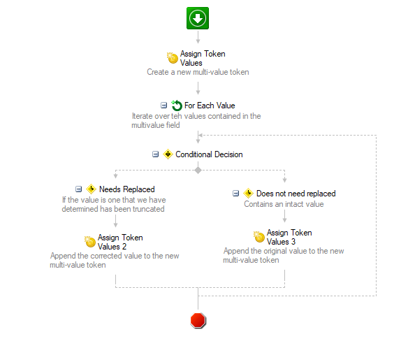

Try something like this:
  1. Create a new multi-value token
  2. Use the For Each Value activity to iterate over your existing multi-value field
  3. Inside the For Each Value activity, examine each value.
    1. If the value is one that needs to be replaced, place the correct value in the new multi-value token
    2. If the value does not need to be replaced, place the existing value in the new multi-value token.
  4. Set the multi-value field to be the new token that you created.
Basically, you are going to build a new set of values, and throw the old ones away. I don't think there is any way to modify multi-value token values in place.

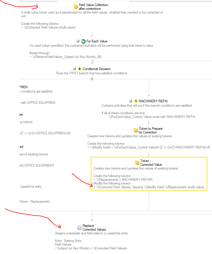

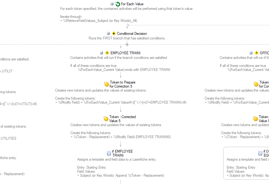

replied on July 5, 2018
Here is what I created today (with nine different corrections/conditions).  Mine does what I think you're saying yours does.  Is there something I'm not seeing in yours?
It looks like you got it. Sorry, it appeared that you were still having trouble. Is what you came up with working?
replied on July 6, 2018 • Show version history
Connie
Instead of applying the field within the for each, just push the value into a multi value token, as Devin stated above.
After you have looped through all values in your original multivalue token and pushed corrected values into a temp multivalue token, you then write the corrected temp multivalue token to the entry (overwriting the original values).

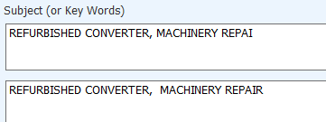

HA!  SUCCESS!!!
BEFORE    AND AFTER

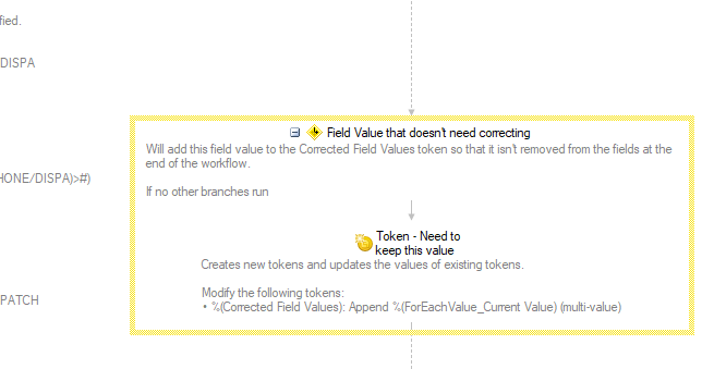

Based on Bert's comments, I
  1. took the activity he crossed off and placed it after the Conditional Decision,
  2. placed a multi value token before the Conditional Decision to hold all the values,
  3. added a branch at the end of the Conditional Decision to catch any values that didn't need correction
And it worked!  With some tweaking, of course.  The Machinery Repair below was my test branch.  I'll have to make these corrections to all the other branches now.
And here's the additional branch that was needed to catch (placehold) all the fields that didn't need corrections:
THANKS, GUYS!
Devin, I think you were also trying to describe this solution, but I just wasn't getting it until something Bert said clicked.  Now I see what you were trying to tell me.
Thanks!

Do you know how you are ending up with so many fields cut off like that? I couldn't help noticing that they are all getting truncated at 15 characters. Is there something weird about your field that might be doing that?
replied on July 5, 2018 • Show version history
Thanks, Devin.  I'm going to build the workflow.
The data is being filled in from our Financial software and the programmers have only allowed 15 characters for that column.  I have asked that we contact our software providers and shift some of the allowable spaces on those columns, but I've been told that it isn't an option.  I'm still pretty sure it could be done, however, at the moment I am forced to work with it as it is.

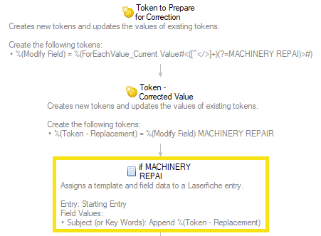

Okay, so it's not a perfect solution, because I can't get WF to just replace PART of ONE of the multi-value fields.
If I tell the Assign Field Values to REPLACE the VALUES then it replaces all values with just the one part that needed correction.  That is okay if it was only those words in the field, but sometimes it is not.
I have created tokens to change only the part I want changed, but then I have to decide, "What do I want more?":
  1. Do I want to "Replace Existing Values" (will wipe out all the other field values!) (NO!)
  2. Do I want to "Append to existing values" (will add it, but leave the field value with the uncorrected words) (NOT SO MUCH)
See examples below (using MACHINERY REPAI as the piece that needs correcting) that show results of "append" when there was only one original field value (acceptable) and one where there were a number of values (not so acceptable, because sometimes there are hundreds of these multi-value fields on one document and maybe 10-20 of those hundreds of values need changing).
Larger multi-value example (before and after):
After storing in the repository and having Workflow run this correction:
The "Replace" option replaces ALL VALUES!

I was really hoping that we could have an IF THEN statement in the Token Editor of this Quick Fields activity that could cover multiple variables:
