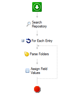

Assuming this is all uniform, if you have access to Workflow this can be done fairly easily. You would create a search and loop through all the records that return. Then you set metadata in your loop.
If you do not have Workflow or Quickfields there is not an easy way to do this.

I am trying this via WORKFLOW and working with the Assign Token Value activity. I couldn't find the Parse Folders activity you have above. I assume is the same since it has the same icon.
I am pulling up the entry path for the document in the folder and applied formatting that I found that just pulls the last folder information that I can then apply to a token value. I cannot find anything on TRIMing the folder information to get the middle folder. I am using ([^\\]+)$ to get the end folder and I can use ([^\\]+) to get the first folder (000000123) but not sure how to get the middle folder out of the expressions I have found so far. I am guessing I could use a LEFT and RIGHT trim to only pull characters 11 through 19 from the RIGHT which would be the 2nd folder (0001234567) (i.e. out of  ...\0001234567\000000123\).

Correct, it is just an assign token values. To look at your folder values, I would take a look at this post. https://answers.laserfiche.com/questions/117453/regex-token-editor-to-pull-folder-name-from-middle-of-path#117738
