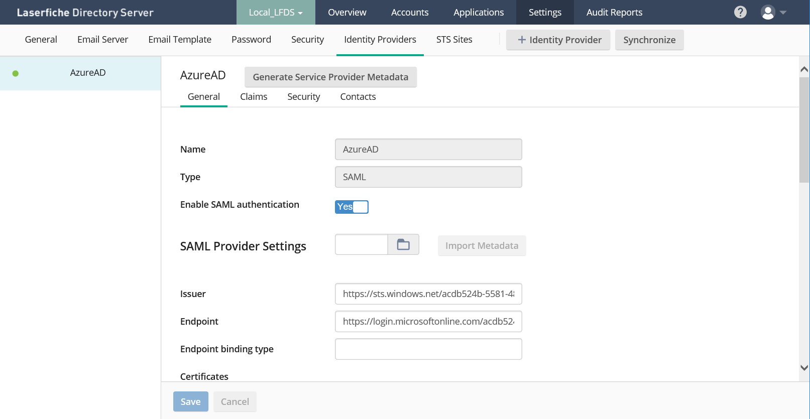

I have set up a SAML IdP in LFDS 10.3 and populated the Issuer, endpoint and certificate with the SAML Entity ID, SAML Single Sign-On Service URL and SAML signing certificate from the Azure AD application registration page - see LFDS_IdP.png

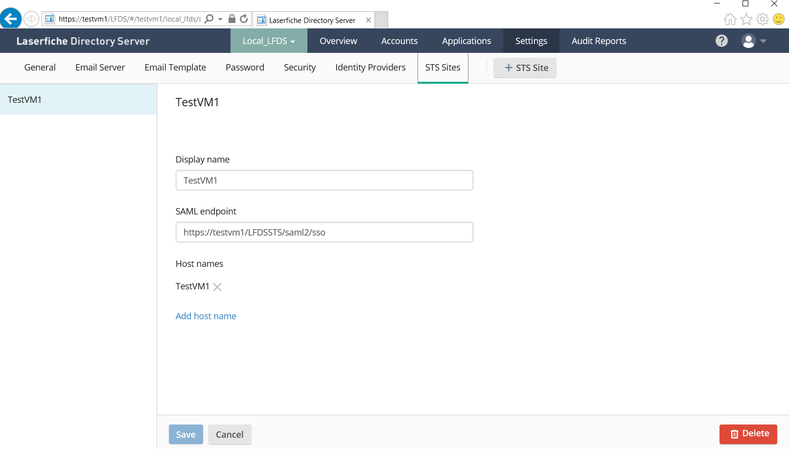

I've set up an STS site with the suggested endpoint displayed in the LFDS configuration - see  LDFS_STS.png

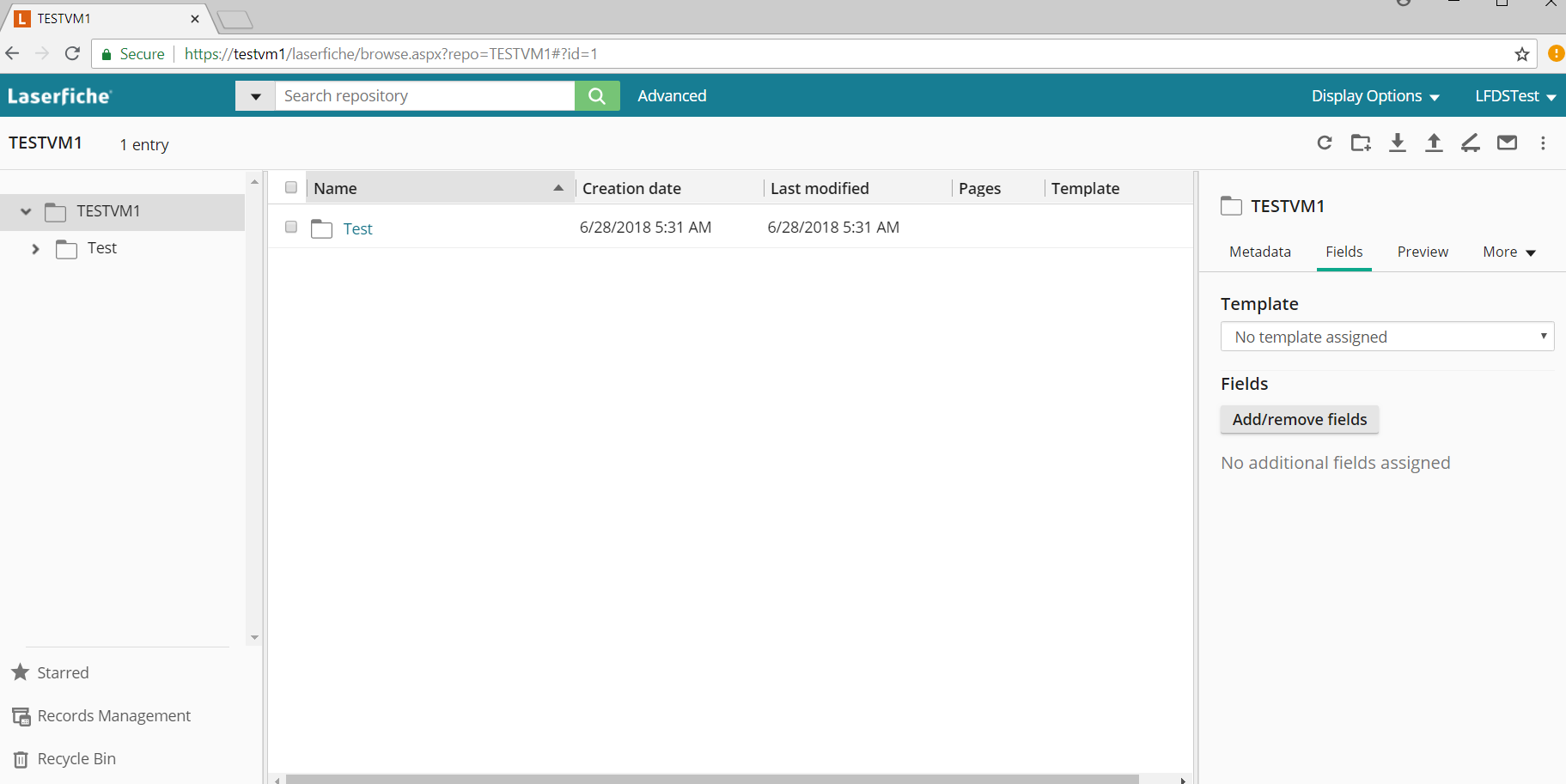

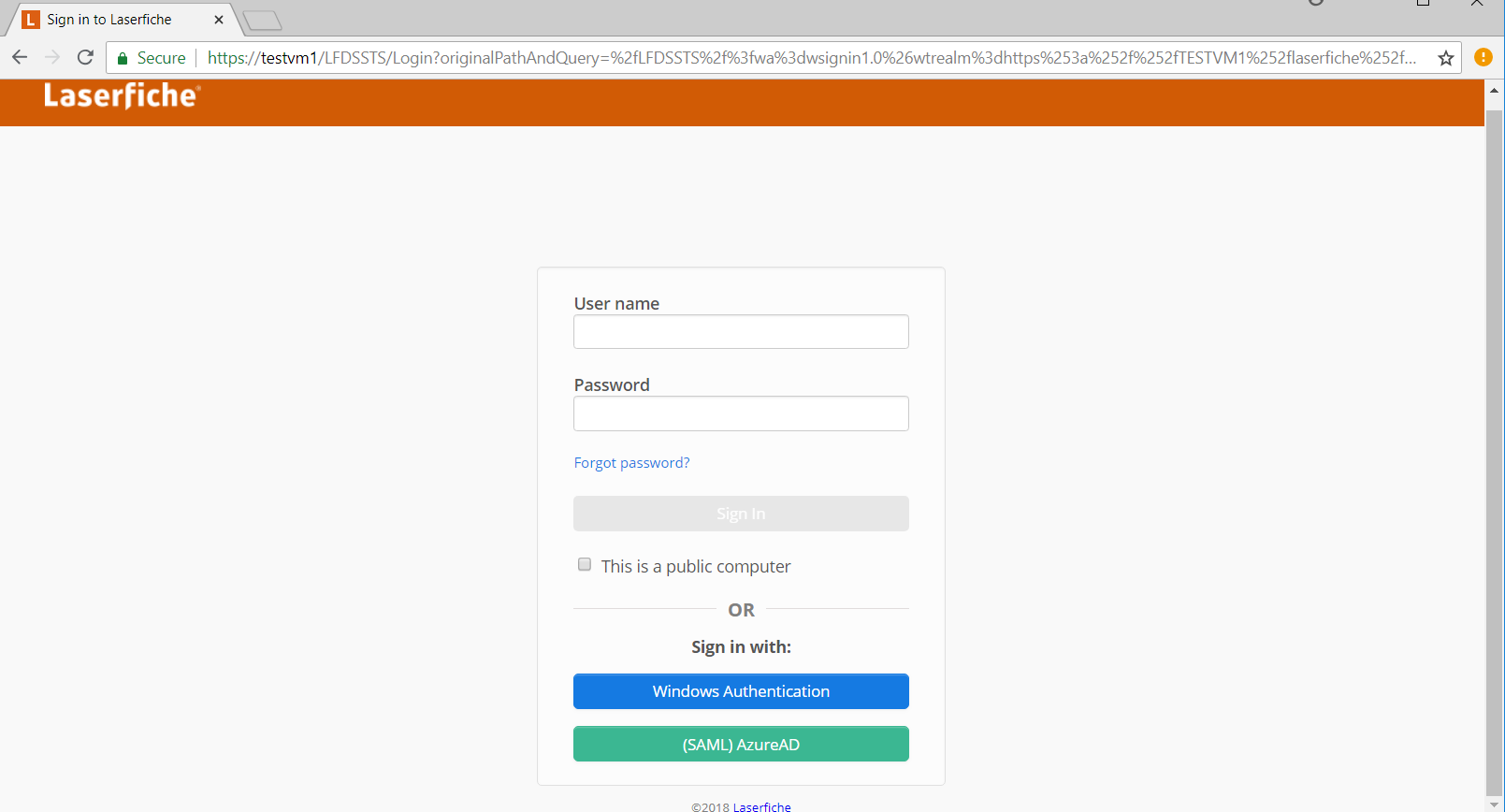

I am happy that LFDS is set up OK as I can authenticate fine if i use an LFDS account and authenticate via the directory server page - see LFDS_login_page.png; LFDSTest_loggedin.png

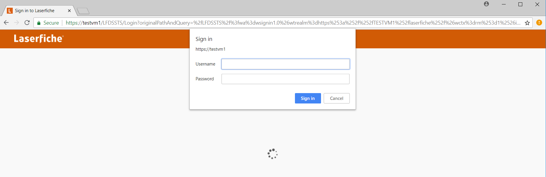

However, if i use the SAML button on the directory server page i get prompted for windows credentials and am unable to get any further - see windows_auth_prompt.png
Using fiddler I can see that the windows authentication happens against https://TESTVM1/LDFSSTS/specificapi/login/login  (the same url the LFDS account auth uses and gets no authentication challenge)

replied on July 16, 2018
Laserfiche support identified that no binding type was specified and recommended urn:oasis:names:tc:SAML:2.0:bindings:HTTP-POST
Putting this as the endpoint binding type parameter got us past the Windows auth prompt.
