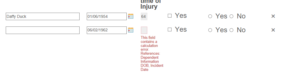

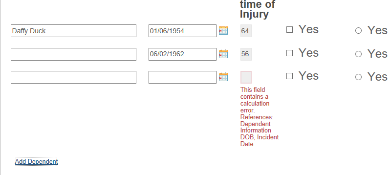

I have a DateDif calculation on a field in a table - =DATEDIF(INDEX(Dependent_Information_1_1.DOB,ROW()),Date_of_Injury,"Y") It will not fill in the age until another row is added. It should calculate for the current row. Here is how it looks before and after I add another row.

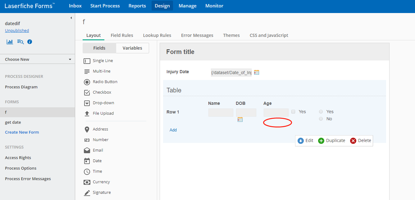

I tried to reproduce the issue with Forms 10.2.1.255, 10.3.1.552, but I cannot reproduce it. Below is what I did to try to reproduce it.
I used a separate Date field as Date_of_Injury; and inside the table, Single Line field for name, Date field for DOB, and a Number field for age(time of injury) which contains the field. I also tried a Single Line field for age(time of injury).
I have the Date_of_Injury filled always as today(current_date). No matter I typed in the DOB, or selected a date from the calendar, or populated the DOB from lookup rules, it works for me: every time after a date is filled in for DOB, the age is calculated in the current row.

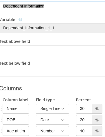

1. What is the field type for your Date of injury field? and the field type for your "time of injury"? (Maybe this won't be the root cause, but will get me a better idea to reproduce/find the issue.)

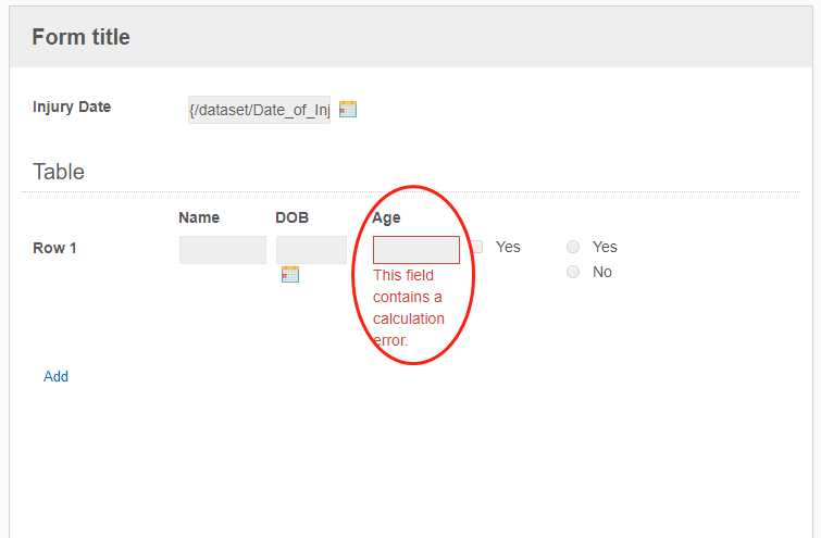

2. On your Forms Designer, do you have the same error? I mean while you design the form, do you see the error on that page? After you add the formula, refresh the page to try to validate the formula.

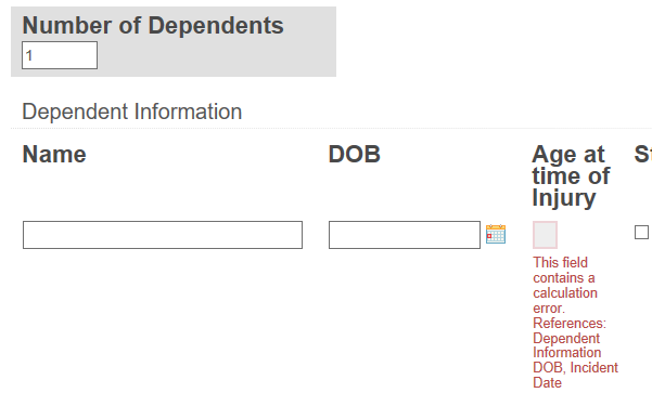

For example, I don't have an error:
If there's an error:
I ask this because seems in my form, there's no that error message shown. I want to check whether we have the formula with correct variables(also correct type variables) already validated.

I ask you this is because that I saw you have the table as "Dependent_Information_1_1", seems to me that you have three tables (you might have deleted some of them), one is "Dependent_Information", another is "Dependent_Information_1", can you help me check that the table you are referencing is the one you are currently on?

I verified the table name and field types -
Date of Injury is a date field
I do not see the error in forms designer. This table is hidden until the field Number of Dependents has a number in it. The error appears when I add a row on my form. The calculation is resolved when I add another row. If a row is added and then deleted the calculated amount remains.
I think
I think you are correct, it has something to do with how the data is in the field. When I do it in preview mode and add the date, it works fine. When I do it with my task, I have to add a row before it calculates.
