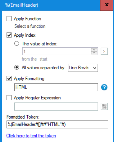

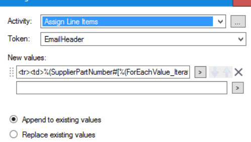

Basically, I have created a HTML table that is being emailed from LF Workflow using the following:
https://www.laserfiche.com/solutionexchange/amplify-your-workflows-with-html/

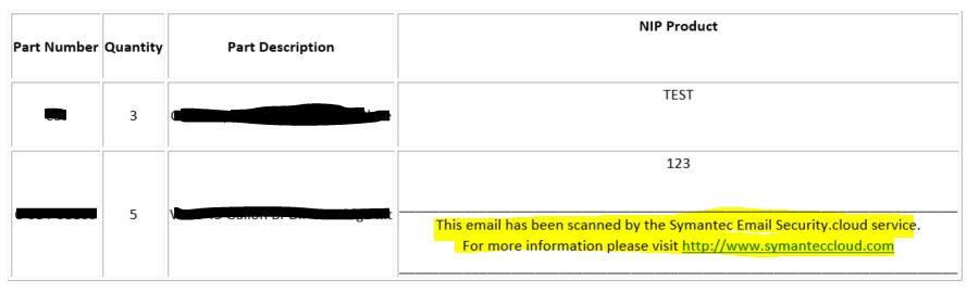

The issue is, when the email is being sent out, it is adding the virus scanning message within the table as per below:
The HTML formatting being used is the following:
Email Header Token:
The Email Header Token within Email send:
The email details for the table:
Now, I did try adding an additional table at the end of the email to see if that message will move there but nothing happened and it still embedded itself to the actual Table.

We have managed to find the solution for this, by adding the below within the Email Body:
Initial:
<table border="1"><body style="text-align:center;">%(EmailHeader#[]##"HTML"#)</body></table><p></p>
Updated:
<table border="1"><tbody style="text-align:center;">%(EmailHeader#[]##"HTML"#)</tbody></table><p></p>
This has now moved the Symantec Email security to the bottom of the email,
