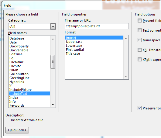

Yeah, I figured. So I tried pushing Word to see what it can handle in its field properties. It looks like it allows a mail merge field inside a IncludeText field:
or, if you toggle field codes on both:
So now I have a field to inject the file name into the IncludeText field. This field will now appear in the Simple Merge option in the activity and you can use conditional decisions to pick which file you need to use and make a token with the name.
I haven't tried it, but I think if you need to have multiple files added, you can set up each one with a token and leave the value blank when the file shouldn't be inserted.

"IncludeText" works for me.
The only catch is that any path or URL you specify has to be available to the Workflow Server from the perspective of its service user. Any mapped drives need to be specified as UNC paths as service users don't see mapped drives.
But that's not a merge field, so I'm not seeing a good way to make that conditional.

The permissions make sense.  When I try this, it inserts the text immediately.
What we are looking for is to make that field a variable and insert different rtf files depending on actives in the workflow

Wow, that toggle field code is helpful.  I just tested this and it works.
I have the code in there and I have a token in workflow simply hard coded to the name of the file.  Then in the update word doc activity I am using said token instead and it pulled the right file.  Very helpful info Miruna, thank you.
